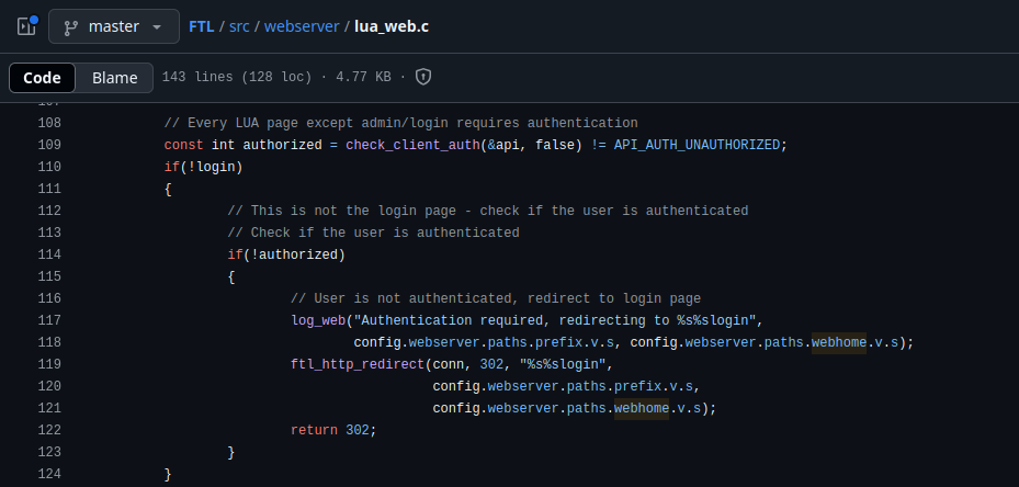

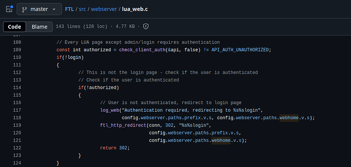

In file lua_web.c, the code enforces authentication for every LUA page except admin/login, as explicitly stated:
I'm proposing that authorization should be enforced only for paths inside config.webserver.paths.webhome, so that the following becomes possible:
Running Pi-hole on bare metal
Setting webserver.serve_all = true in the config (or UI)
Placing a test.lp file inside /var/www/html
Running curl -v http://127.0.0.1/test
Expected behavior: Instead of a 302 redirect to /admin/login, I want a 200 OK response.
I get that Pi-hole isn't meant to function as a full-fledged web server, but wouldn't it be neat if this little tweak allowed just a bit more flexibility?
Looking forward to your thoughts. Thanks for considering this!
