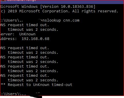

problem presently is, command line from any PC, NSLOOKUP, shows me:

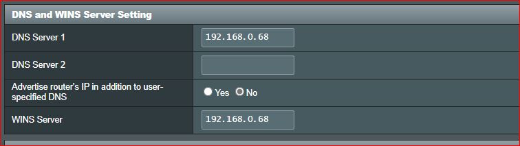

And thought to post my router (asus) lan side, DNS settings of which nothing changed, only the new modem.

In this snap of your router settings, you should not select the "advertise router's IP..."

"In this snap of your router settings, you should not select the "advertise router's IP..."
  • It isnt selected to advertise.

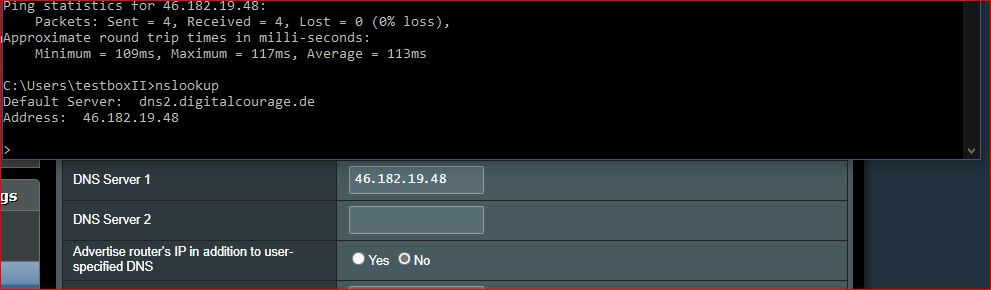

i decided to bypass my PI via the following
and as this screenshot shows i can immediatley resolve again.
so my new modem does work, and as does my router, as it relates to having installed a new modem.
i can load websites and as i am addind to my thread here w/o using my mobile hotspot as i have earlier today.

I set my router's LAN DNS to something else this evening so I could be on with my business. Then a moment ago i decided to putty into my PI and update the pi-hole. pihole -up

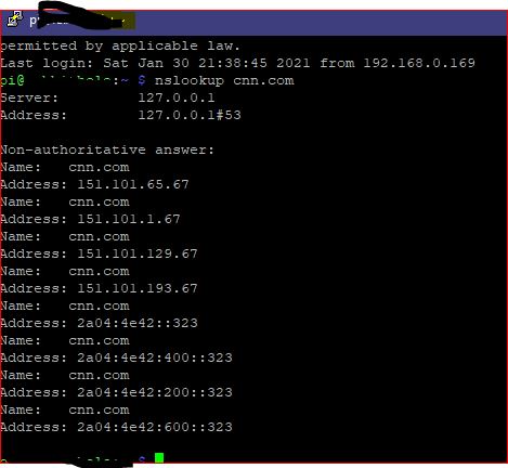

while still in putty i did a nslookup and it gave me a promising output.

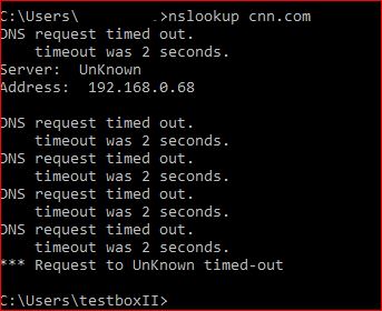

went to my PC and did a nslookup from cmd line, and i was back in business, my Pihole was back and resolving!.

I had already putty-ed into my Pi and did a nslookup cnn.com and it gave me a output.
I went to my pc, command line, nslookup cnn.com, and same timed out issue like earlier in the week when I cam upon here to open this thread...ugh.
from putty: success
from pc command line no success
