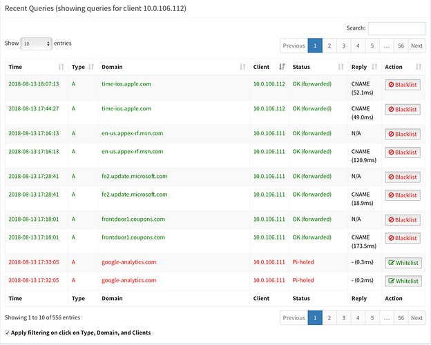

Can you paste a screenshot of what you are seeing when you do the query? Or screenshots(s) if needed.
Here is what I see when clicking a particular client.

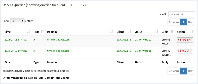

And what does it look like if you search for that IP in the Search box on the top right?
Like so:
We can't seem to replicate this. Did you flush your browser cache after updating?
