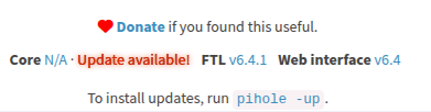

After upgrade to v6 (from v5) the Web (admin) interface shows N/A for Core Version
The issue I am facing:
Ran pihole -up to upgrade from v5 to v6 and everything went smooth, the only difference is that the admin page now needs to be accessed via HTTPS by default and terminal commands now require sudo privileges… both of which are ok.
When I checked the versions in the bottom of the admin interface, I notice that Core shows N/A and prompts for an update. Running phole -v returns the following:
Core version is v5.17.2 (Latest: v6.3)
Web version is v6.4 (Latest: v6.4)
FTL version is v6.4.1 (Latest: v6.4.1)
Looking through other posts, I saw a recommendation to run pihole -r to repair the upgrade, same result.
Additionally, I tried with sudo pihole updatechecker, which runs without issues but doesn’t solve the problem. After running this, I reloaded the admin interface and tried in an incognito browser window; both show Core N/A.

This is just a cosmetic issue. Nothing related to Pi-hole is broken.
Your Pi-hole is updated, as showed by the debug log:
[✓] Version: v6.3
[✓] Version: v6.4
[✓] Version: v6.4.1
The most strange part is:
the versions file was updated, but only the CORE_VERSION value is wrong.
All other values (including CORE_HASH) are correct:
-rw-r--r-- 1 pihole pihole 643 Dec 31 10:02 /etc/pihole/versions

Maybe the file is corrupted.
Could be… should I leave it like that and see if the next update recreates/updates the file correctly? Or do you want me to try something?
Let's try to recreate the file.
Move the current file using this command: mv /etc/pihole/versions /etc/pihole/versions.old, then run sudo pihole updatechecker.
Does this fix the issue?
Recreating the file works and the interface now displays the correct version.
Thanks for your help!
