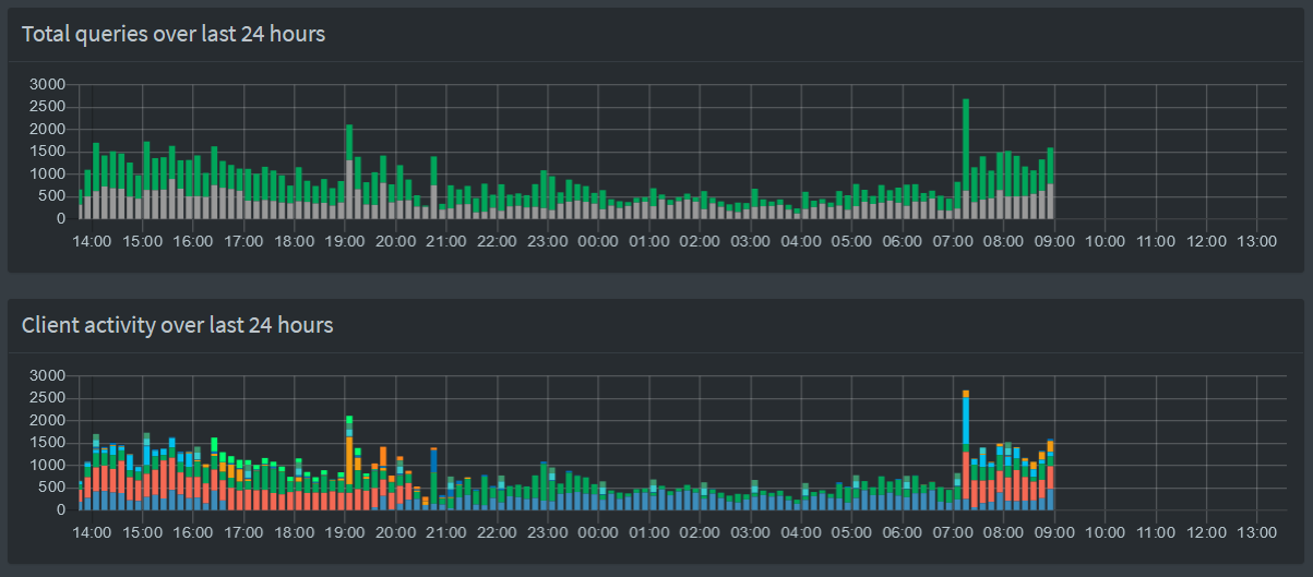

After updating local DNS (added address), data is lost over +- 5 hours (dev branch)
Changes in local DNS settings do not cause loss of data
When adding new entry in local DNS, I lose data
(FYI, I am on the dev branch, latest version)

I could do a bit longer with the current situation, as the overall functionality of the network does not seem (too) affected. Very curious to see what the team will find!
