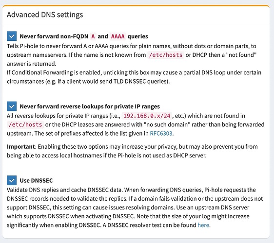

I can't see your tricorder, but are you using a custom DNS? Try switching instead to Google DNS, e.g., and see if that changes anything. It looks to me like a lot of root lookups for some reason and I'm wondering if unbound is creating a denial of service attack or something. Maybe also turn off DNSSEC.
My upstream dns server was OpenDNS. I changed to Google and nothing changed.
OK. What is your DNSSEC setting in the DNS section, out of curiosity?
Just a guess but try turning DNSSEC off.
turning DNSSEC off seems to work now.
But WHY?
I didnt change anything after the update.

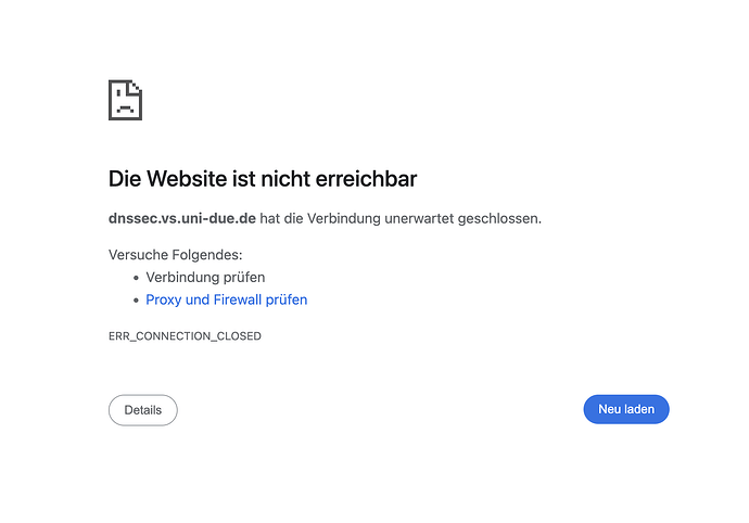

That question is above my pay grade. Perhaps the resolver test in the text of setting would provide an answer until a developer can weigh in?
tried it:

By the way, the DNSSEC resolver test site is permanently down. The working one is DNSSEC Resolver Test

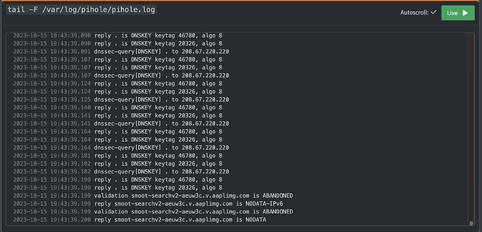

We are not yet able to reproduce this behavior so we also don't know yet what to fix. Could you check out the file /var/log/pihole/pihole.log on your Pi-hole itself (not via the web interface) and quote a few lines from there?
The reason I'm asking is that the web interface is hiding an intermediate part of the log lines showing us which process is doing this. I just want to exclude that there is some heavy TCP worker activity going on.
Also, development-v6 contains many commits of the bleeding-edge dnsmasq that have not been in the latest v5 release. This is by 99% the reason why you are seeing what you are seeing here.
