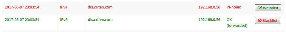

After applying the last update(FTL Version), ads not being blocked, passed on via ipv6 but ipv6 is not enabled
it shows the site blocked on ipv4 and not blocked on ipv6
If you don't have IPv6 enable then there isn't a way for advertisements to get through. The green record shows that IPv6 specific "AAAA" records are being passed, but they return an IPv6 address, which your clients can't reach. We are looking at a way to disable the display if you truly have no IPv6 on the network, but for now your Pi-hole is working just fine.

thanks I've added ipv6 edge.quantserve.com to the blacklist and it's still showing green (forwarded)
I don't know if that's where the ad is i just think it should be noted that I've added it and it's still forwarded.. but i see the blacklist doesn't list ip version.
That's a false positive, since you don't have an IPv6 address for the Pi-hole, it doesn't know to use IPv6 AAAA blocking and it instead sends the DNS requests to the upstream. The only way currently to get those to show blocked would be to set up a Unique Local Address (ULA) for IPv6 on the network. But for now, they will show green, even though nothing is coming in to the network that way.
