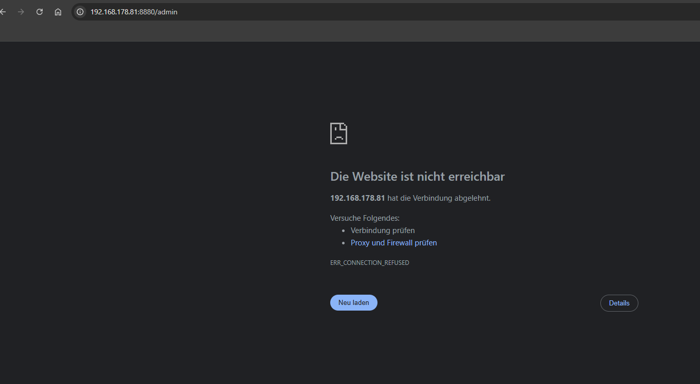

I tried some other ports too, but it doesnt work.
The website is unavailable.
https://tricorder.pi-hole.net/1mWNL2wE/
   [2025-04-15 19:14:51.413 CEST 1223286] Initializing HTTP server on ports "8880,443s"
   [2025-04-15 19:14:51.413 CEST 1223286] cannot bind to 443s: 98 (Address in use)
   [2025-04-15 19:14:51.413 CEST 1223286] Failed to setup server ports
[✗] tcp:*:443 is in use by apache2 (https://docs.pi-hole.net/main/prerequisites/#ports)
[✗] tcp:*:80 is in use by apache2 (https://docs.pi-hole.net/main/prerequisites/#ports)
Apache2 is already bound to 443, you can't bind Pi-hole to that same port. Since you didn't mark the ports as optional, FTL can not start the web interface.
