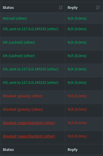

Hello,
I noticed today after updating to the latest beta version that all queries that happened before the update show the string (other) appended to all status massages in the Query Log. This phenomenon is independent of the update process, though, and happens every time the DNS resolver is restarted in general.
The reply column is showing N/A for all queries because that information is not stored in the database and therefore cannot be retrieved. That is normal. However, I didn't find any info about what is supposed to be displayed between these parentheses.

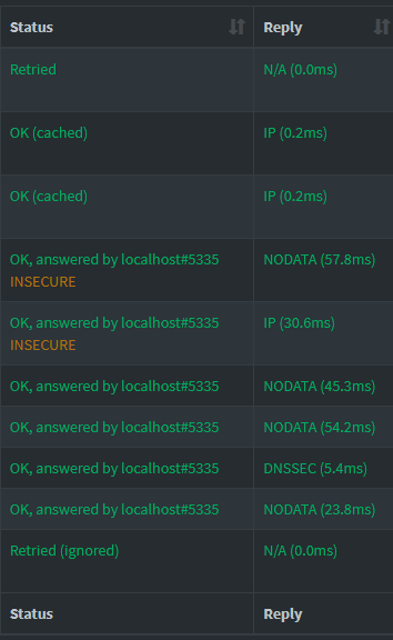

Here is what is usually displayed during normal operation for reference (there is no additional additional information in parentheses at all):
What does (other) mean in this case and what info is supposed to be displayed in these parentheses normally?

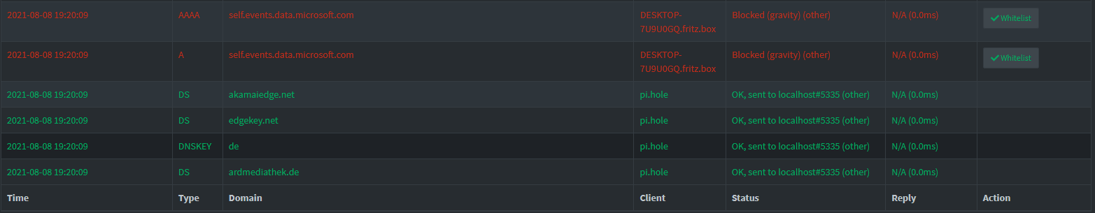

In this case I looked for a DNAME record (type ID 39 according to wikipedia) for testing:
Before restarting the DNS resolver:
grafik
After restarting the DNS resolver:
grafik
There is no DNAME record for google.com, so naturally there was no reply. Still, the Status column has this string (other) appended to it after the restart. I thought it might have something to do with DNSSEC, but this was with DNSSEC disabled, so no. It happens with DNSSEC enabled or disabled either way.

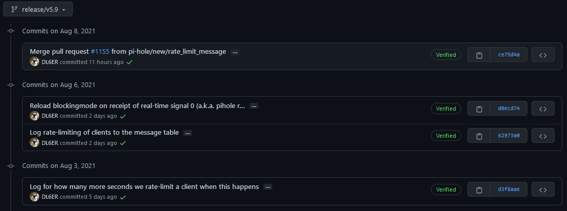

Should the fix have been in one of the last 3 commits? I was on d3f8aae on the initial report.
Sorry, I've just hit git push but didn't check it succeeded (you guess it: it didn't). The commit is now pushed.
Looks good :+1:
