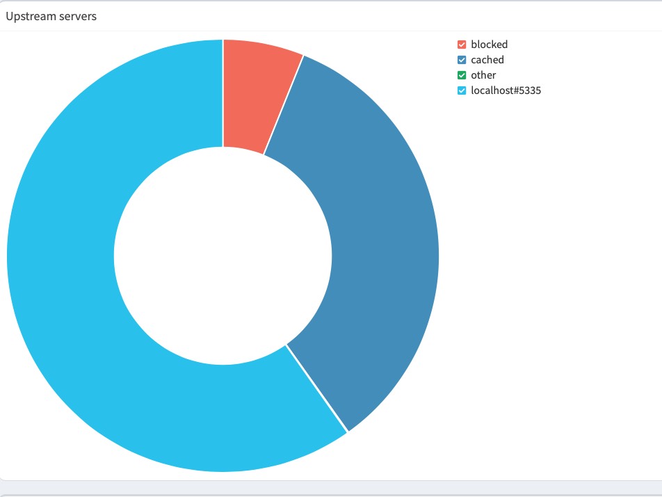

I am running Pi-Hole v5.8 - FTL v5.13 - Web Interface v5.10 on a virtual machine as a recursive DNS for my Linux box.
Recently I found that DNS setting I put in my ADSL modem pointing to the VM running pi-hole had been changed.
I noticed it only because I logged into pi-hole and noticed that the upstream server graph looked different.
So I logged into the modem, saw the DNA setting had been changed to point to an external DNS server and changed it back to mine, 192.168.1.5.
No big deal but it should not have happened.
Maybe because of a reset I did not notice, a power cut while I was away from home?
In any case, I was looking to see if there was some indicator of the DNS being used in the pi-hole Dashboard so I could easily check it at a glance but have not found it.

It's not clear to me what you want to see.
The dashboard shows you the upstream DNS servers being used by Pi-hole, in the right hand pie graph.
The DNS server being offered to clients by the router is not available in the web GUI but can be obtained with this command from the Pi terminal:
pihole-FTL dhcp-discover

There may be some confusion here. If you are using a recursive upstream DNS server for Pi-hole (e.g. unbound), this is invisible to the router and the DHCP service. The clients would be using Pi-hole for DNS, and Pi-hole in turn is using unbound to resolve domain names that are not blocked by Pi-hole. The clients have no visibility into the upstream DNS server used by Pi-hole.
You can verify that Pi-hole is using unbound by looking at the Upstream Servers pie chart on the dashboard. The local unbound instance will be shown on the loopback IP at the port you assigned - our guide uses 5335.

No. Pi-hole is using unbound as the upstream DNS server. This is separate from any router settings.

Not exactly. You are setting the DNS server to Pi-hole, which in turn is using unbound for upstream DNS resolution. The router does not see or know of the presence of unbound.

Not correct. The link between Pi-hole and the upstream recursive DNS server (unbound in your case) is within the Pi itself and completely independent of any router settings.
Your upstream DNS server is defined on the loopback IP for the Pi (127.0.0.1) and the specified port (5335 per our guide). That link stays intact regardless of anything the router may be changing.
