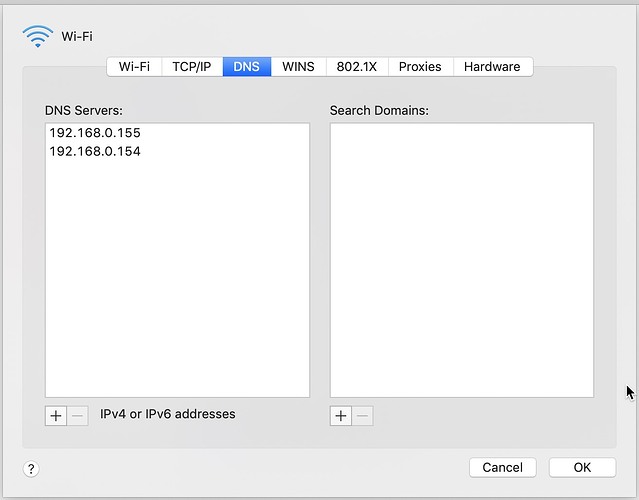

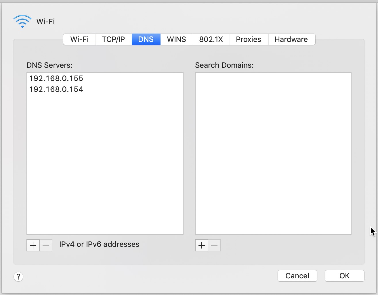

This is telling you that the Mac is not properly configured to use Pi-Hole. it is using Google for DNS and bypassing Pi-Hole. What do you see on this network DNS panel on your Mac? It is likely the same numbers. If so, then edit the settings and put the Pi-Hole IP there, and nothing else. Then apply the changes.
You can clear the Mac DNS cache with this command from the Mac Terminal:
sudo killall -HUP mDNSResponder
Oh bugger! I had some issues with my DNS a week or so ago, so I guess that is where I changed that. When I deleted the Google DNS servers, it 'defaulted' to 192.168.50.251, do I need a second one?
You do not need (or want) a second one.
