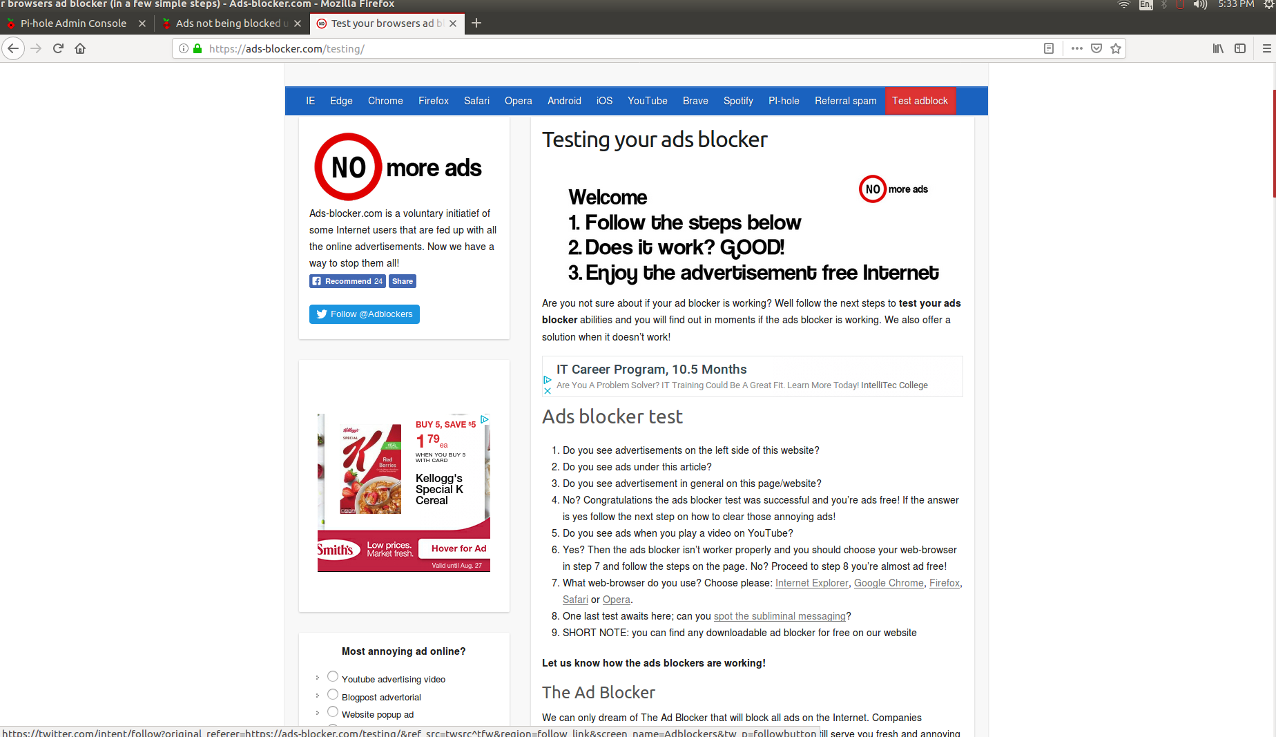

Engadget is having some trouble loading right now, but here's an adblock testing site.
Since Pi-Hole appears to be working based on your debug log, let’s look at whether or not clients are using Pi-Hole for DNS and whether Pi-Hole can block ads on the visited site. I would use the engadget site for consistency.
Use these tools while loading that site (clear the browser cache first), and see if the traffic in the Pi-Hole log matches the domains that the site is loading.
I can see all of the same domains in both. I refreshed the page several times while trying to figure this out. What's weird is that the ads don't show up for the first few times I load the page after I clear the cache. After I refresh several times, they start to pop up. Once an ad has appeared, it doesn't go away again until I clear the cache (not necessarily the same ad, but just an ad in that space on the website).
I would bet there is an alternate DNS path available to your client. I would change browsers, review browser settings, etc.
