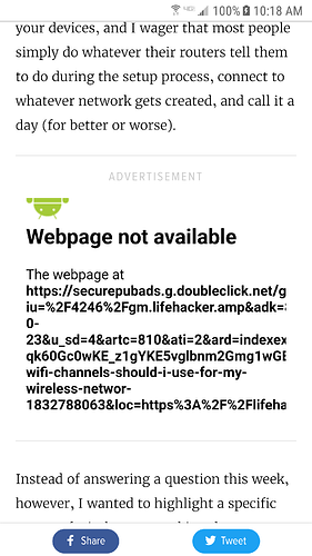

A couple of weeks ago I set up my Pi-hole. Everything seemed to work good initially. The ads displayed as blank white space on all my connected devices. But for the last week or so, I'v been noticing that all (most of) the ads are now displaying a screen with "Webpage not available" at the top and a web address where the ad should be. I've included a screen shot from my phone.

This appears to be a function of the browser you are using - it is showing this when it could not load the element that appears in the reserved block of space.
I don't believe this is a problem with your Pi-Hole. Your debug log shows no problems.

I just thought it was odd that (from what I remember) the space was all white initially and then now it's getting the "Webpage not availabe" message. And the fact that a couple other people I know didn't have that issue.
