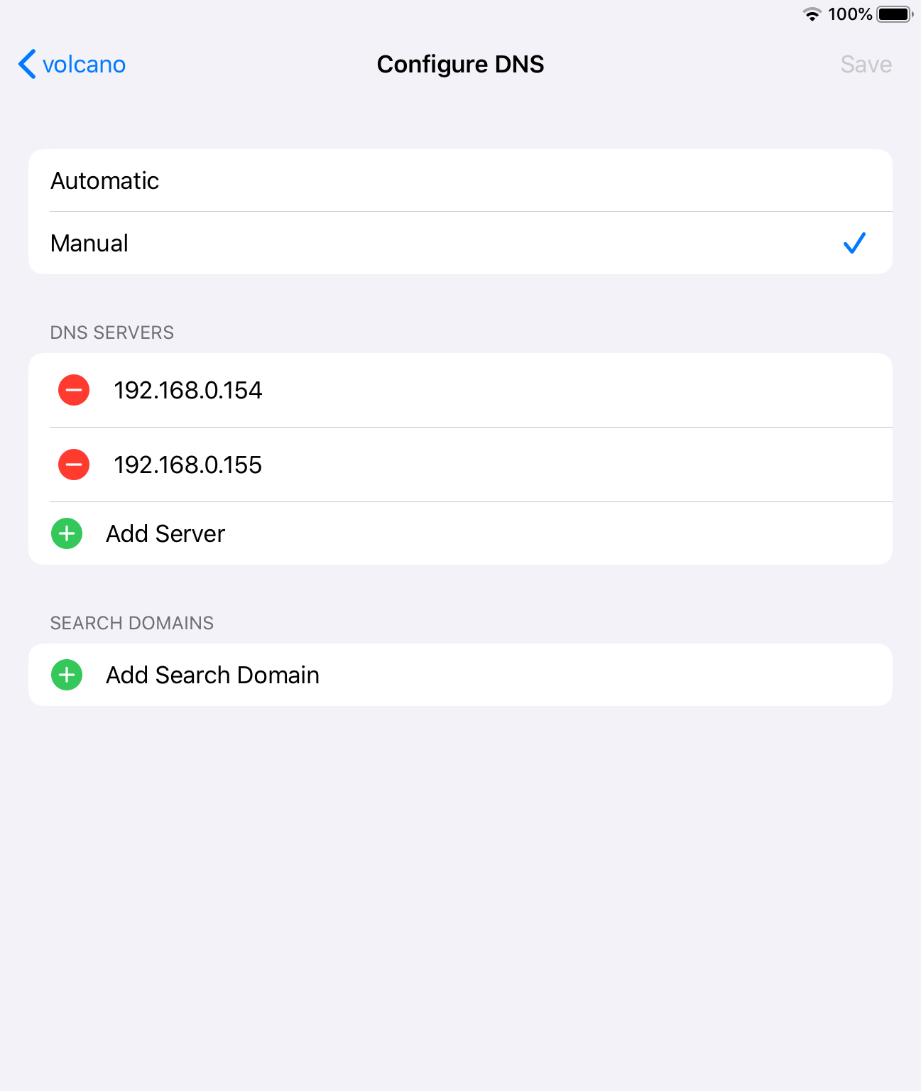

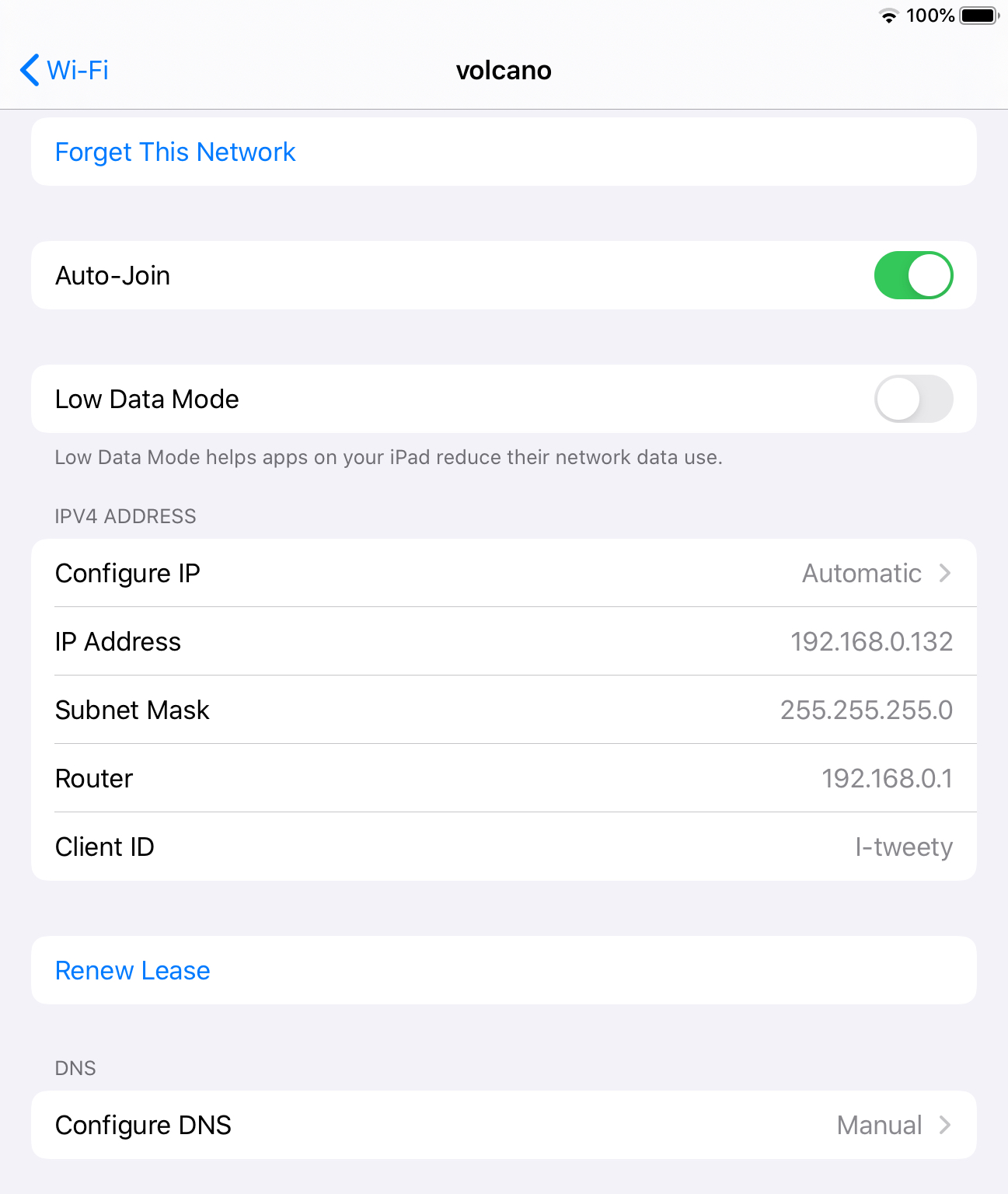

Here are some example screens from an iPad on a network without IPv6 enabled and manual DNS assignment.
Unfortunately there is only an IPV4 address listed. Except for the IP-addresses, my settings look exactly like your screenshots.
IPV6 was not configured on my router as it was not needed, so I never enabled it.
