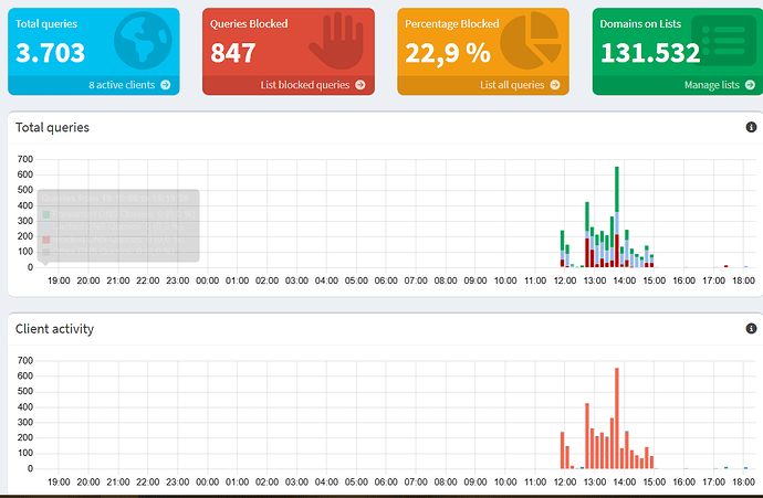

I ran into a problem I unfortunately can't solve myself.
Background:
I set up Pi-hole in standard config on my pi3b.
IP4 and IP6 addresses are set to static.
For the first two hours or so, everything works fine and ads are blocked.
After this time I get an error and ads are no longer blocked
DNSMASQ_WARN Warning in dnsmasq core:
ignoring query from non-local network 2003:cb:4fff:22:7297:41ff:fe82:6a1d (logged only once)
Kernel:
Linux pi3 6.12.20+rpt-rpi-v8 #1 SMP PREEMPT Debian 1:6.12.20-1+rpt1~bpo12+1 (2025-03-19) aarch64
Ads should be blocked as queries are registered and detected by pihole.
Ads are no longer blocked and I see a massive decrease in queries registered (so they are bypassing the pi-hole)
https://tricorder.pi-hole.net//S7h3TrRy/
Has anybody faced something similar and can give me a hint on how to solve this?
Cheers,
Julius
