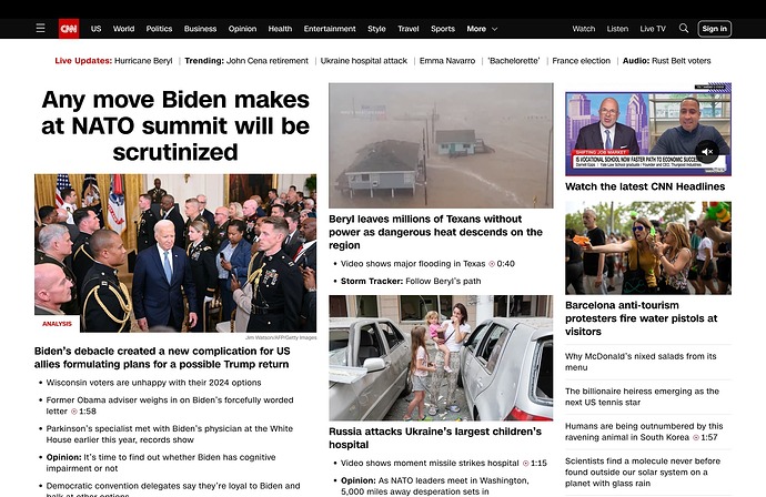

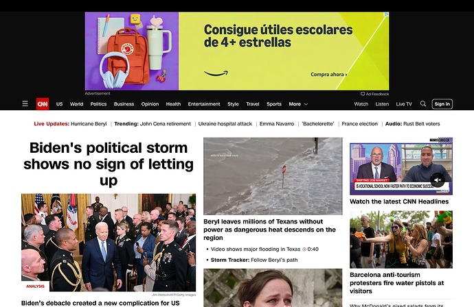

Given all of this, I would expect that most ads I run into get trapped by Pi-Hole. In fact, I would expect that some websites are ad-free, like cnn.com which I have seen recommended as a test with blatant results.

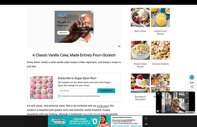

In practice, it looks and feels like... Pi-Hole is not even working. I see extremely few differences whether Pi-Hole is enabled or disabled.
(To be clear, I am talking about regular ads in web pages, not ads on, say, Youtube/Hulu/etc. as I realize those are outside the scope of Pi-Hole.)

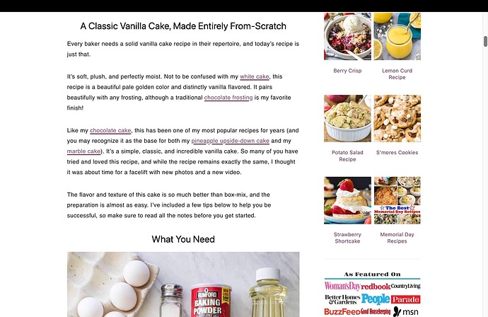

See the following screenshots that display some pages with Pi-Hole enabled vs. what I see with uBlock Origin enabled for some sort of comparison.
I did not include the screenshots with Pi-Hole disabled because they are literally the exact same ones as with Pi-Hole enabled.

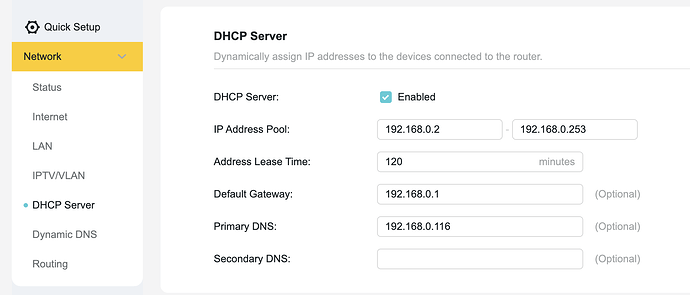

Are you able to remove that secondary DNS from your router's DHCP so it's only giving out Pi-hole's IP? If it requires two servers, you could try making both entries the Pi-hole IP as a workaround; that sometimes works (depends on the router and its firmware). Then take the computer offf and back on the network to pick up the new settings, and test again.
Oh interesting, I thought it was in my best interest to have a secondary DNS setup if, say, my RPi were to die or something.
I have removed the secondary DNS from the router DHCP, switched off wifi on the laptop then back on to rejoin the network, but unfortunately same result on cnn.com, ads galore.

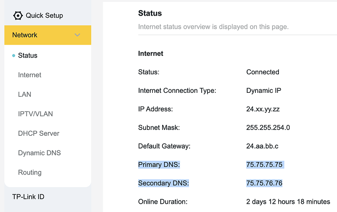

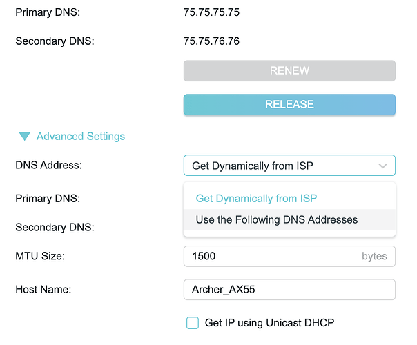

I was surprised to see the following however on my router's status page, although outside of the DHCP configuration (therefore not editable), and I'm not sure if that has any impact:
A handy mod for that command is this one, which just shows the relevant in-use nameservers:
scutil --dns | awk '/scoped/,0' | grep nameserver | sort | uniq

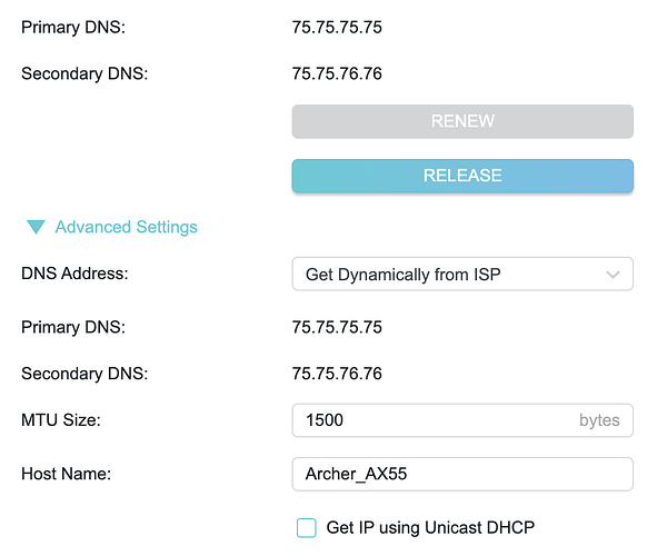

You can see in your screenshot that the router's IP might still be in use here for DNS. If so, that will also bypass Pi-hole. You want Pi-hole's IP to be the only DNS in use.
Those are Comcast DNS servers for the router to use. Think of them as the router's upstream DNS servers. With you directing clients to use Pi-hole instead they're not so relevant, although the router itself can still use them. If you want you can use those with Pi-hole, by setting them as the Custom 1 and Custom 2 servers in Settings > DNS, and unticking the others.

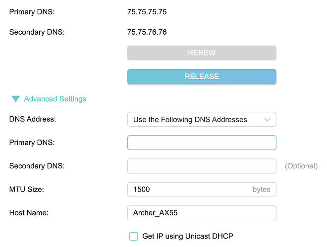

However, I just saw that I can indeed update those values:
Could this be the key? (i.e. Pi as the main DNS, nothing in DHCP DNS config, and let the router advertise its IP as a DNS server)
I was using the guide at TP-Link - Pi-hole documentation, but maybe I'll try this instead: https://www.youtube.com/watch?v=L1nWlQKYRu4

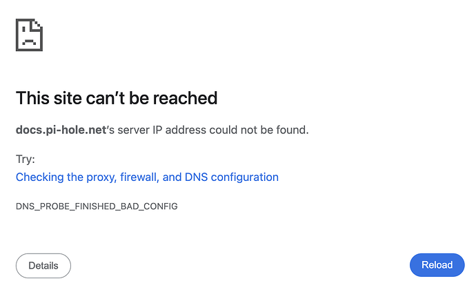

Nope nevermind, that broke everything. All pages after that were showing:
And the Pi-Hole's diagnosis tab said:
Gaaah what am I missing... :thinking:

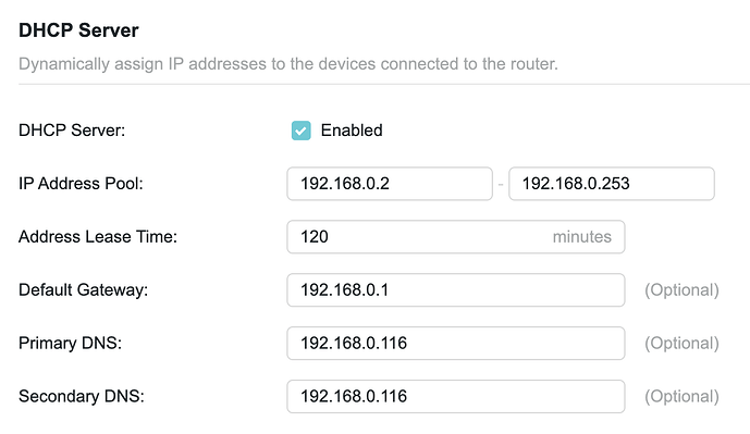

Progress, by setting up both the primary and the secondary DNS values in my router's DHCP, I can get a list without my router IP's:
% scutil --dns | awk '/scoped/,0' | grep nameserver | sort | uniq
  nameserver[0] : 2001:4860:4860::8888
  nameserver[1] : 2001:4860:4860::8844
  nameserver[2] : 192.168.0.116
  nameserver[3] : 192.168.0.116
I don't know why I didn't try to do that before.
Better, but... still the same tons of ads!

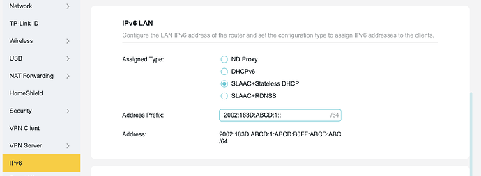

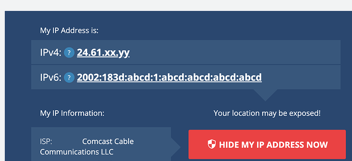

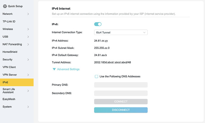

Oh, interesting. Again, I'm not super knowledgeable about this so that's helpful, thanks. I don't know if this helps inform anything, but this is the IPv6 config in my router settings:
In addition, https://whatismyipaddress.com/ does report my IPv6 (but again, I don't know if that means anything in particular):
(all xx, yy, abcd, etc. are obfuscated by me, not the pages I screenshot)

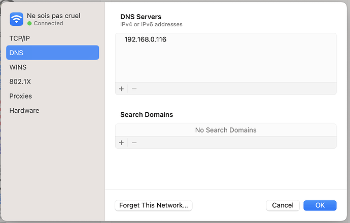

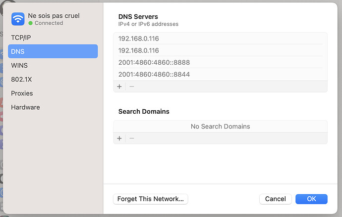

This is what the macOS settings you mentioned look like at the moment:
Sadly nothing too relic-ey as the match what the CLI command returns.
I cannot delete any of these of course, but I can set the Pi as the only value in there:
Alright I did that and the DNS tab still shows the only server I set (last screenshot). If I remove it, I have the same 4 servers as the screenshot before that.
That's helpful, thanks!
I did just that (last screenshot), renewed the DHCP lease, tried again... ads and ads again :frowning:
Neither of these things worked either, unfortunately.
Any other idea? :frowning:

Just a suggestion from a fellow user: you may want to toggle off the IPv6 setting button on your router, especially while you're getting things set up for the first time. Since the router is making IPv6 available to your LAN, you have to make sure your Pihole is expecting that and it requires chasing down the right DNS addresses, etc.
When I ran a Synology router, I tried a similar effort as you with IPv6 but kept running into unexpected ads and other things. So I turned IPv6 off and stuck to IPv4, and my Pihole situation was much easier to manage. I didn't miss out on a thing by not allowing my router to use IPv6, since Pihole can resolve AAAA records (IPv6) either way.
You can always turn it back on when you feel like you've got a good handle on Pihole/Unbound with IPv4, or you can leave it off.
Thank you @nprampage, I'm going to try this. @chrislph, do you confirm this is something I might want to look into? Or is there anything else I should try instead / on top of it?
Omg that was it! I don't know why I didn't try that earlier, tbh. Maybe because I don't like not running IPv6 (mostly an opinion initially, then turned muscle memory).
Anyway, I can easily test back and forth, enabling/disabling IPv6 on my router and reconnecting to the network, and each test correctly hides or shows ads accordingly. I'll be damned.
You're right, I'm going to leave it disabled for now while I'm testing things and making progress, but I'd love to try and enable this later on once Unbound/etc. are satifactory to me. Let me know if you have any resource on the Pi-Hole + IPv6 topic I could learn from :slight_smile:
Thank you, fellow user! (and @chrislph as well of course, I learned a ton!!)
