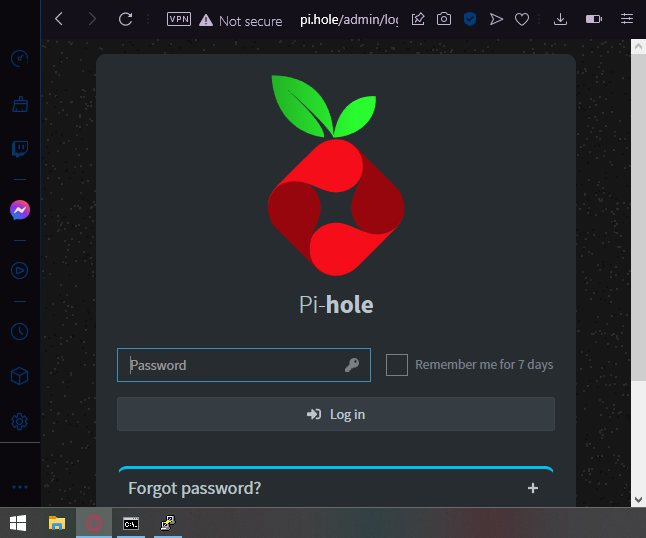

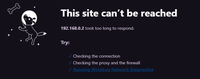

I recently installed Pi-hole with unbound on an old pc running Debian 11. I can get to http://pi.hole/admin perfectly fine with it but other devices on my network are having problems accessing it even if I use my Pi-hole's address (attached img). The devices other than the localhost listed in my Pi-hole's network tab are also highlighted/shaded in red; "Device(s) does not use Pi-hole". I can successfully ping and access Pi-hole using an SSH terminal with its IP & hostname so I'm not sure what's preventing me access.

The clients are likely not using Pi-hole for DNS. Only Pi-hole can resolve the domain name pi.hole to the Pi-hole IP.
This is why you can reach the Pi-hole by IP, but not by domain name.

Sounds as if a firewall is active on the Pi-hole host.

Applied the rules for IP tables, executed the ufw commands, and- lo and behold:
Ta-Da!.mp3
Celebratory screenshot of the admin page running on another machine :partying_face:
Guess I overlooked this since most guides don't cover firewall rules during installation. Was under the assumption something else was up. Thanks a bunch!
