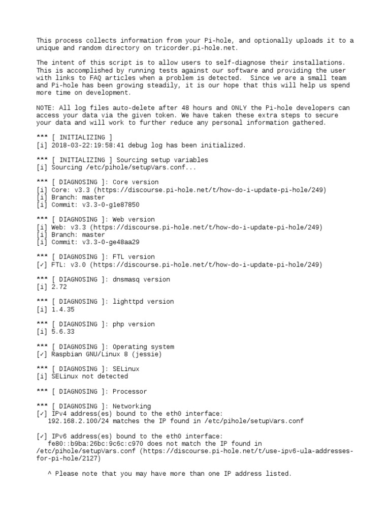

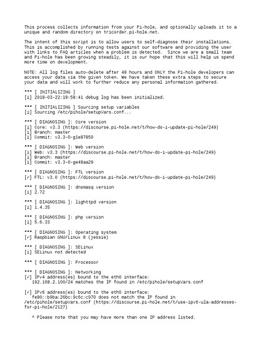

Sorry, but I can't seem to fix this.
Maybe I'm not seeing the connection to the solved thread.
In this case, I cannot get dnsmasq to start. DNS service is not running. And so FTL is not up either.
I tried a new debug token. But got an error trying to upload the debug log. (w/o DNS)
Here is the local, sanitized debug log:
