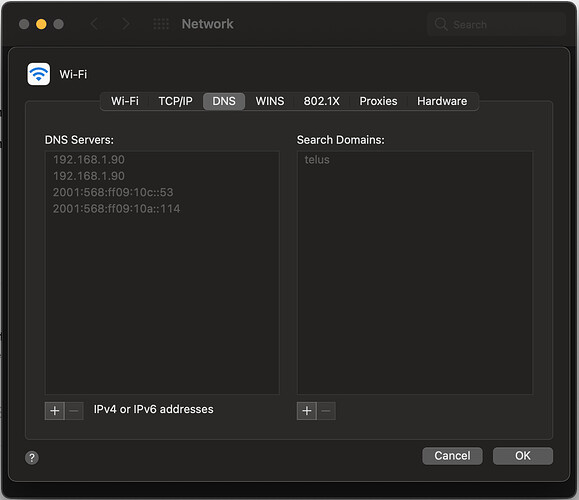

The host machine has IP 192.168.1.90. I've set this as the DNS for my router and all the clients have this as DNS (see attached screenshot). I am not sure where the OpenDNS IP is coming from. Thoughts? Thx.
I fixed the issue. On my router, I disabled the LAN IPv6. I can now access the admin page and things are working perfectly. Thanks for your feedback.
