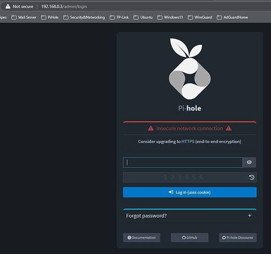

http://192.168.0.3/admin
When I try the second, it does not redirect, but instead recommend upgrade to https

Hi there, you have to check the configuration file /etc/pihole/pihole.toml and in particular the line:
port = "80o,[::]:80o,443so,[::]:443so"
Try to set it to:
port = "80,[::]:80"
and it should disable TLS.
