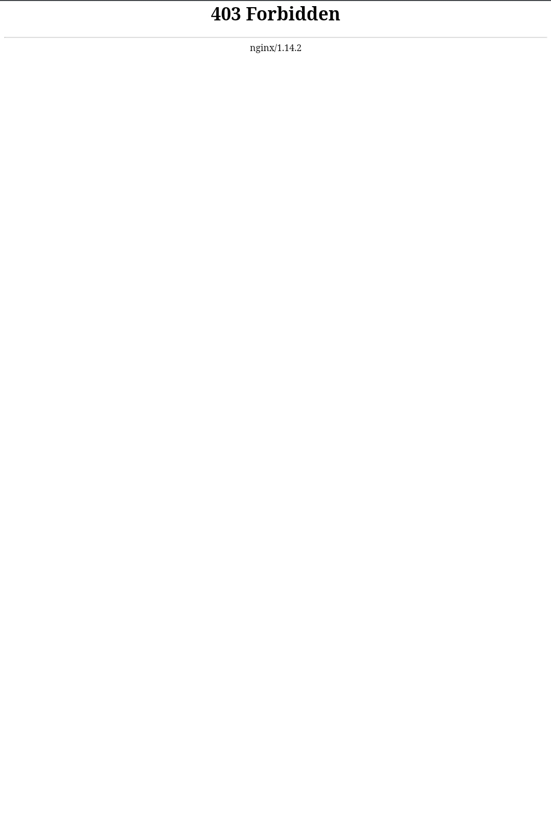

The issue I am facing: When trying to access the admin page at http://192.168.8.103/admin an error will show that says: 403 forbidden and nginx/1.14.2.

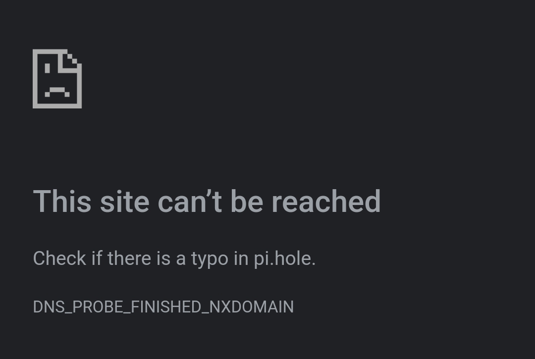

And if I try the same thing but with the pi.hole address it just says This site can't be reached.

Pi-hole uses lighttpd by default. Have you modded it, or is the address maybe not correct? Or are you using a reverse-proxy or a browser plugin that is interfering?
I haven't changed any setting on my raspberry or modded anything. I have the correct address. And I'm using basic google Chrome without any plugins or extensions.
Using nginx as Pi-hole web server is a custom config and you need to make sure all settings are correct.
Did you configure nginx to execute PHP files?
Was something else installed on your Pi 4 before Pi-hole, perhaps, so it got in there first with nginx?
I just configured it but now it says 502 Bad Gateway.
