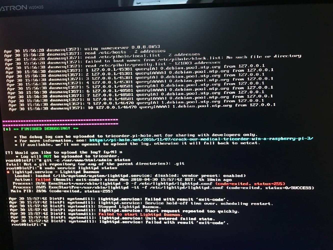

What exactly do you get when you try to open it? A 404 error?
Admin interface should be available under http://pi.hole/admin
What's the output of sudo service lighttpd status

I get the messages as attached. Thanks.
Your lighttp is not starting and that's why you can't access the admin interface.
