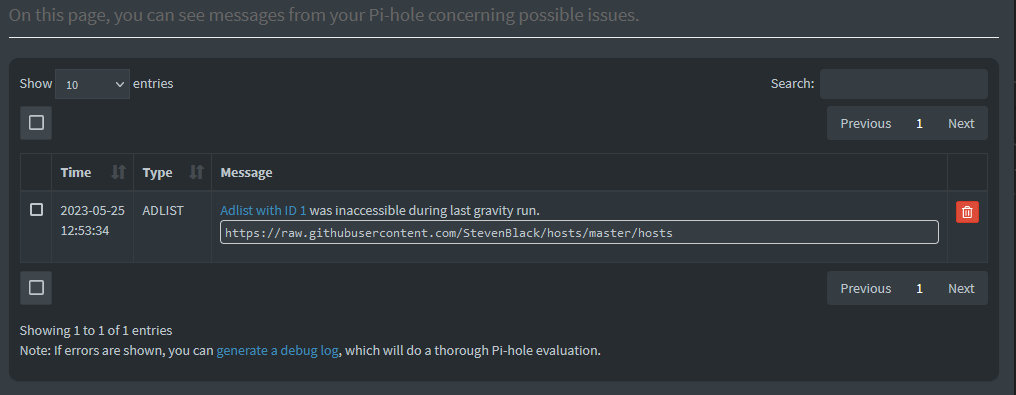

Adlist with ID 1 was inaccessible during last gravity run
I keep getting errors after adding adlist. I using the green highlighted texts lists from firebog. Ive deleted them all and still getting errors when I use the list that came preinstalled. Oddly pihole still seems be working on the phones connect to the wifi, but my PC still gets them.
adlist to update with minimal errors
_ https://tricorder.pi-hole.net/QaNUePNT/ _
The message is just a warning (not an error) saying the list was not accessible during the last update:
   Last gravity run finished at: Wed May 24 11:46:07 PM EDT 2023
The list wasn't updated, but you still have the previous list. Nothing is broken.
Try to Update Gravity again.
Maybe the list was temporary unavailable when you tried to update it.

If you go to Adlists again you'll see an error icon next to the list and if you click it you'll see what the issue was (it was unavailable). As for the message in Tools > Pi-hole diagnosis, an adlist being offline during an update causes the warning message to always be present in there until the adlist is available or removed from Adlists. So you can expect that to be shouting at you for a little while. That's probably what you're seeing there.
Try what @rdwebdesign suggests as it may have just been offline temporarily and is back now.

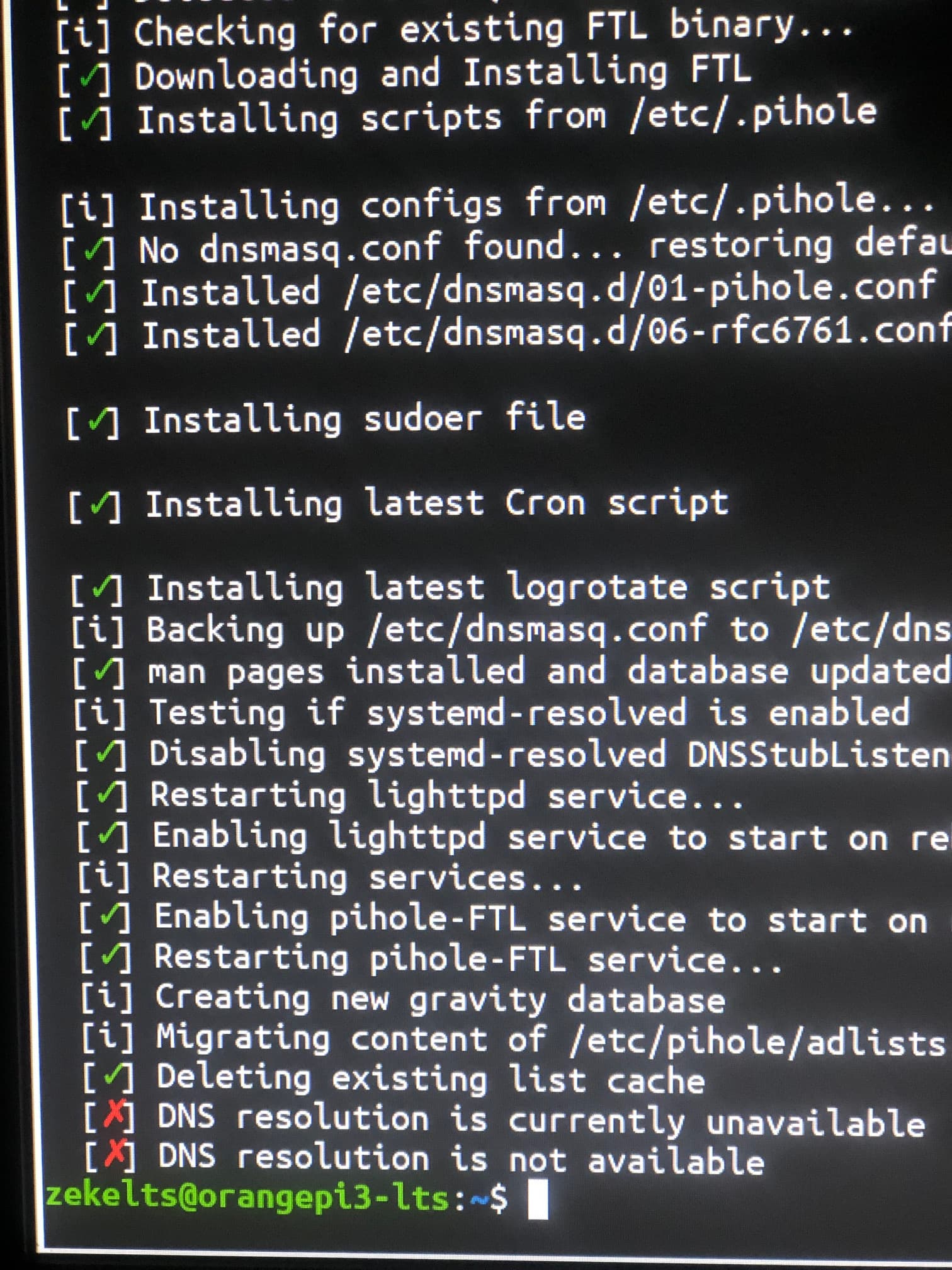

ive been trying to update the gravity list and keep getting:
dns resolution is currently unavailable
[i]time until retry:120
then after the countdown
dns resolution is not available
tried reinstalling armbian and pi from scratch and still getting DNS issue

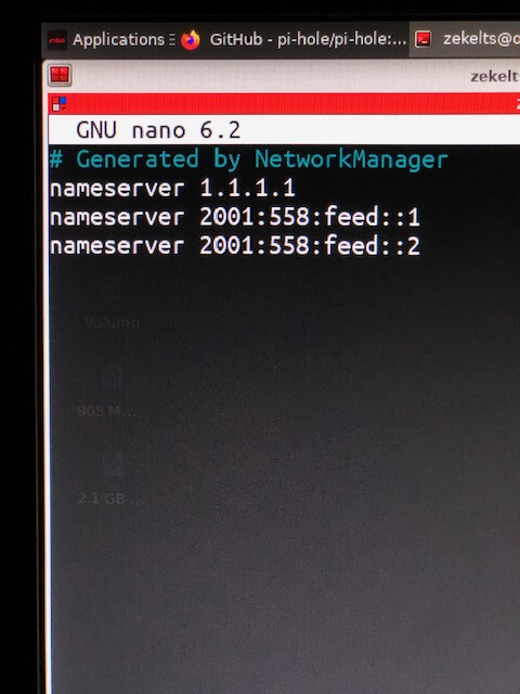

what should the first line nameserver be?
changing it allowed me to update the gravity list

The other problem seems to be that, out of the box, your Armbian installation is having its nameservers set to Comcast's IPv6 DNS servers but seemingly no IPv4 addresses. It appears that you don't have an IPv6 path to those external servers and so name resolution fails, and this is the cause of your Pi-hole terminal error and your adlist failing to be retrieved. You've worked around this by manually adding in Cloudflare's IPv4 server, and since you do have IPv4 connectivity out, that works and gives you name resolution.
It's likely that somewhere in the Armbian installation you can configure or override this setting and ensure that it has a working IPv4 server as standard.
It's not clear how this is all working together but some things you can try are, again disabling IPv6 in your router temporarily to ensure that IPv4 is the only scheme available and thus getting that working initially. If you are using a Raspberry Pi then perhaps try a standard Pi OS Lite image to confirm a working setup, since the workflow for that distro is standard on that board.

with that resolv.conf file, what does the average users resolv.conf file look like? thinking about doing another clean install.
Try taking the PC off and on the network to force it to renew its lease and pick up the updated settings. Then try again, re-run the nslookup command as a handy check. No need to post the output, just see if it's using Pi-hole now or if it's still using Comcast.
resolv.conf commonly has a couple of nameserver entries, example below. These are the nameservers used by the OS (on which Pi-hole is just one of many things installed), not to be confused with the upstream DNS server settings used in Pi-hole's own DNS config in Settings > DNS.
/etc/resolv.conf example
nameserver 1.1.1.1
nameserver 1.0.0.1
Often it's being managed by an external service such as NetworkManager; if so there tends to be a comment on the first line advising. If you change it manually, as you did, it may revert back after some time or after a reboot as the service updates it. A search of this forum will likely find tips on how to deal with that. The Pi-hole installer does a good job of integrating your settings during initial setup.
