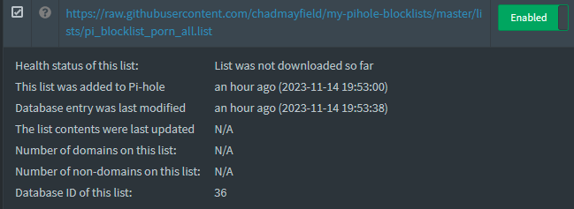

Trying to find an adlist to block porn sites and so far I have a couple, but they don't seem to download or it's taking very long. Not sure if this is normal.
Any suggestions?
After adding the lists, Pi-hole needs to fetch the lists and grab all the entries off it and add them to its database, which is called Gravity. If you do nothing Pi-hole will do this automatically every week. To make it start using the new lists straight away you need to do a Gravity update.
You'll find this in Tools > Update Gravity. Stay on that page until it's done, it will take a few minutes and then turn green. Now look again at the list and it will say "List download was successful (OK)".
