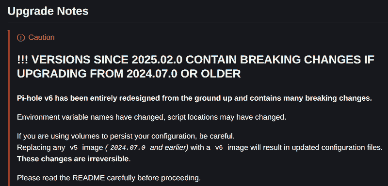

Please also have a read of Pi-hole's Docker notes on Upgrading from v5.x - Pi-hole documentation.

Your environment variables are v5, which would make a v5 upgrade more likely.
Please go over the notes on upgrading from v5.x.

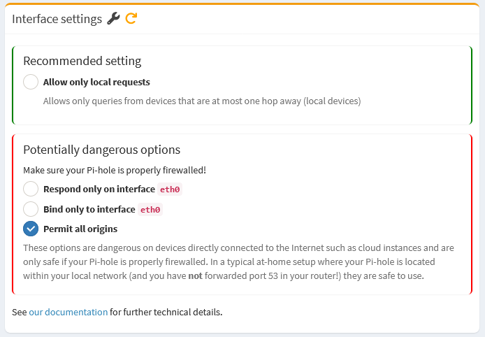

Thanks for the continued help. The situation is, post upgrade, no DNS resolution was occurring and it required me changing the expert-mode UI option (Settings > DNS) from "Allow only local requests" to "Permit all origins" under the advanced interface settings. I have gone through the upgrade docs but don't see they apply in my case because I am not using a custom dnsmasq file nor am I setting any env vars in the Docker Compose file. It is only my assumption that the incorrect IP address being reported in Tools > Interfaces was related to the issue.

You are using bridge docker network. As you can see, there is no 192.168.1.33 inside the container.
This is expected.
As shown in the docker README file - Tips and Tricks, you need to set the Interface settings to "Permit all origins":

The docker compose you've shared explicitly maps specific IPs and ports into your Pi-hole container:
Regardless of Pi-hole's Interface settings, this would mean that Docker would only forward DNS requests directed at your host's 192.168.1.33 into your Pi-hole container.

rdwebdesign, ahh I had totally forgotten about that. I also did not see that line in the README. I think everything is WAI here so thank you all for your input!
