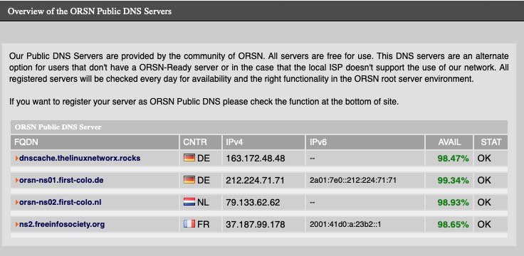

The feature is open for vote, but I'm not sure this is the best inclusion for the global Pi-Hole community. The four public ORSN DNS servers are all located in a relatively small geographical area, while the current defaults are located worldwide.

True, the servers are mostly eu based but i don't think that's much of a problem. Especially not for eu people.
Nice.
All the public DNS servers are EU based:
https://www.orsn.org/map/
I looked at this. Im not sure why there are a couple on the map which are not listed.
That map is where their root servers are located. These are not the public DNS servers.
