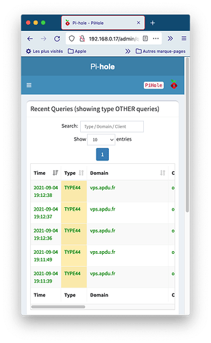

Add support of DNS RR SSHFP (type 44)
The DNS records with RR type SSHFP (SSH Finger Print value 44) are displayed as TYPE44.
It would be nicer to display SSHFP instead.
This record type has been defined in RFC 4255 from 2006.

For now the only RR type I have in the OTHER category is the SSHFP/type 44.
But I have a very small network with few DNS clients.

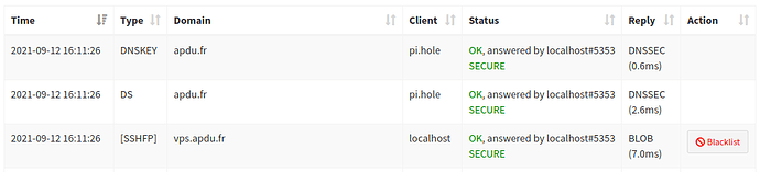

This patch has been accepted upstream. The next version of Pi-hole will be able to display all known query types in the Query Log. We will still summarize those seldomly seen query types (such as SSHFP) as a common OTHER type on the dashboard just to keep the doughnut, or rather its legend, from exploding.
Just a screenshot how if currently looks like on the update/dnsmasq branch:
Note the square brackets around the type indicating that this is a query type that is subsumed under OTHER in the statistics.
