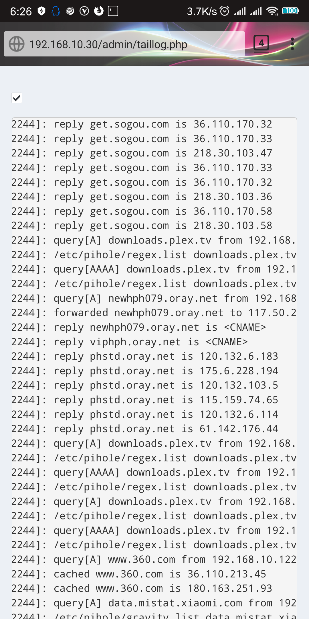

I add some key words of blocked domain in the regex list. If I add these key words more than two, pihole will also block domains with "download" keywords. And I tried to empty the regex list and do a repeat way. This issue will show l, too.

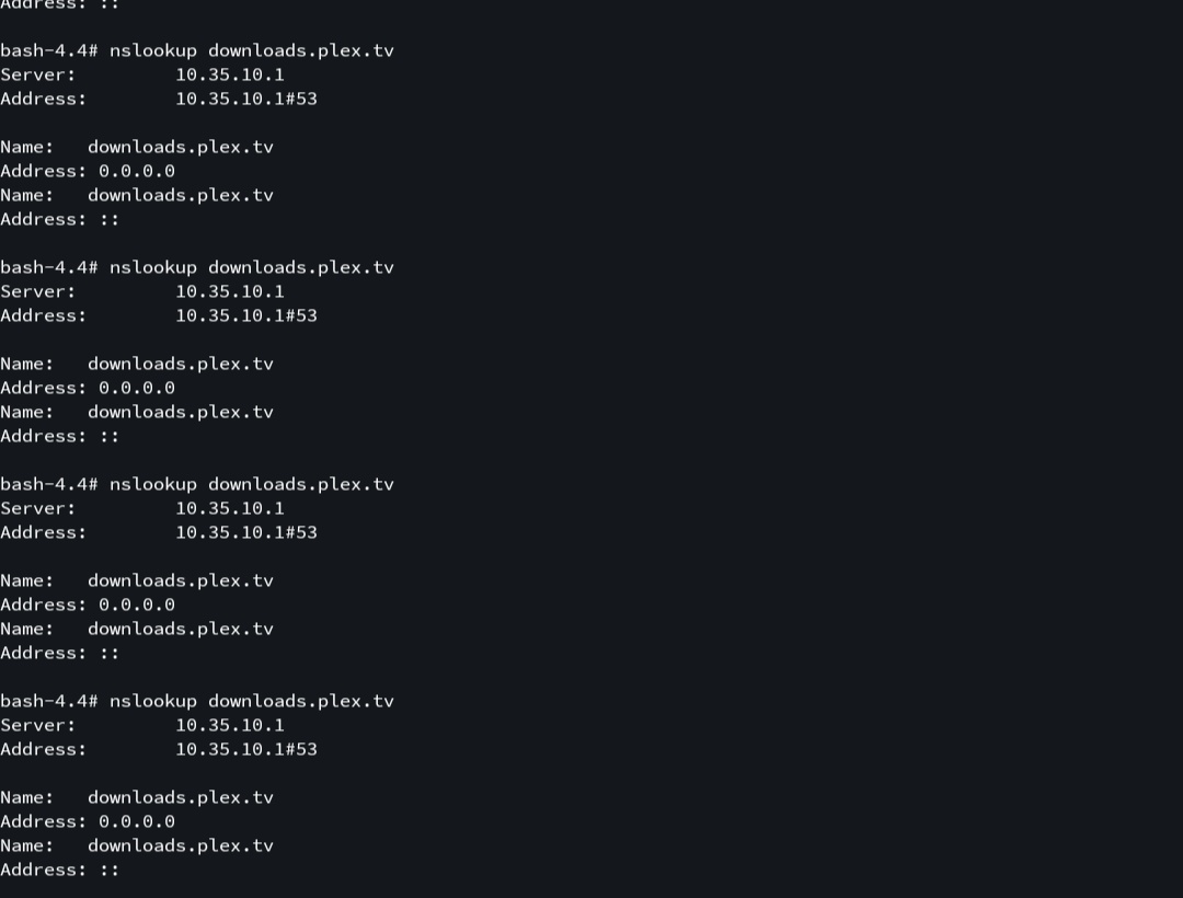

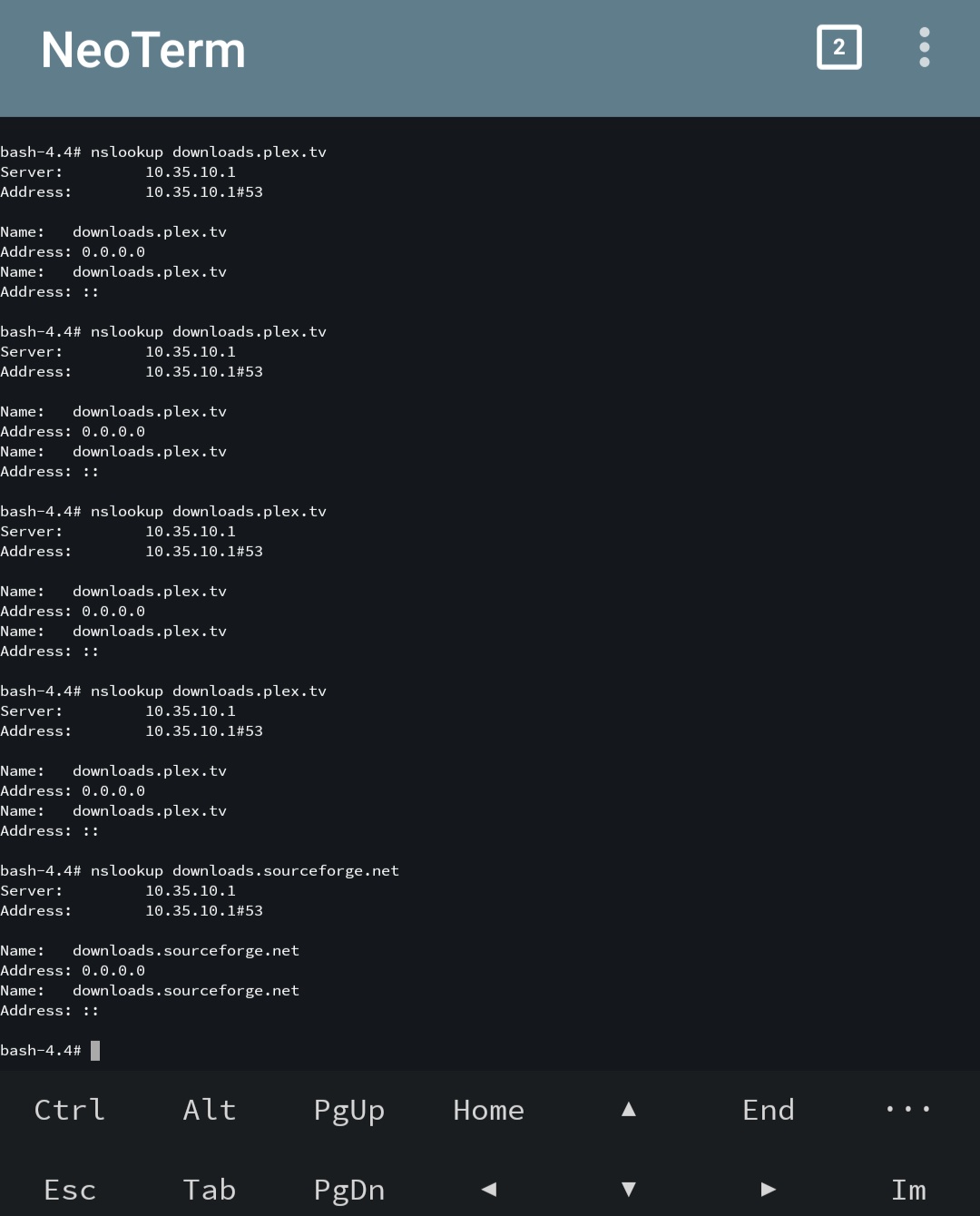

I add one regex keywords of the domain name I want to block. After this action, if I add a keyword again, I use nslookup or dig command, it will return like it below
nslookup downloads.plex.tv
Server: 10.35.10.1
Address: 10.35.10.1#53
Address: 0.0.0.0
It means that it has a regex keyword "download", but there is no this keywords in pihole's regex list.

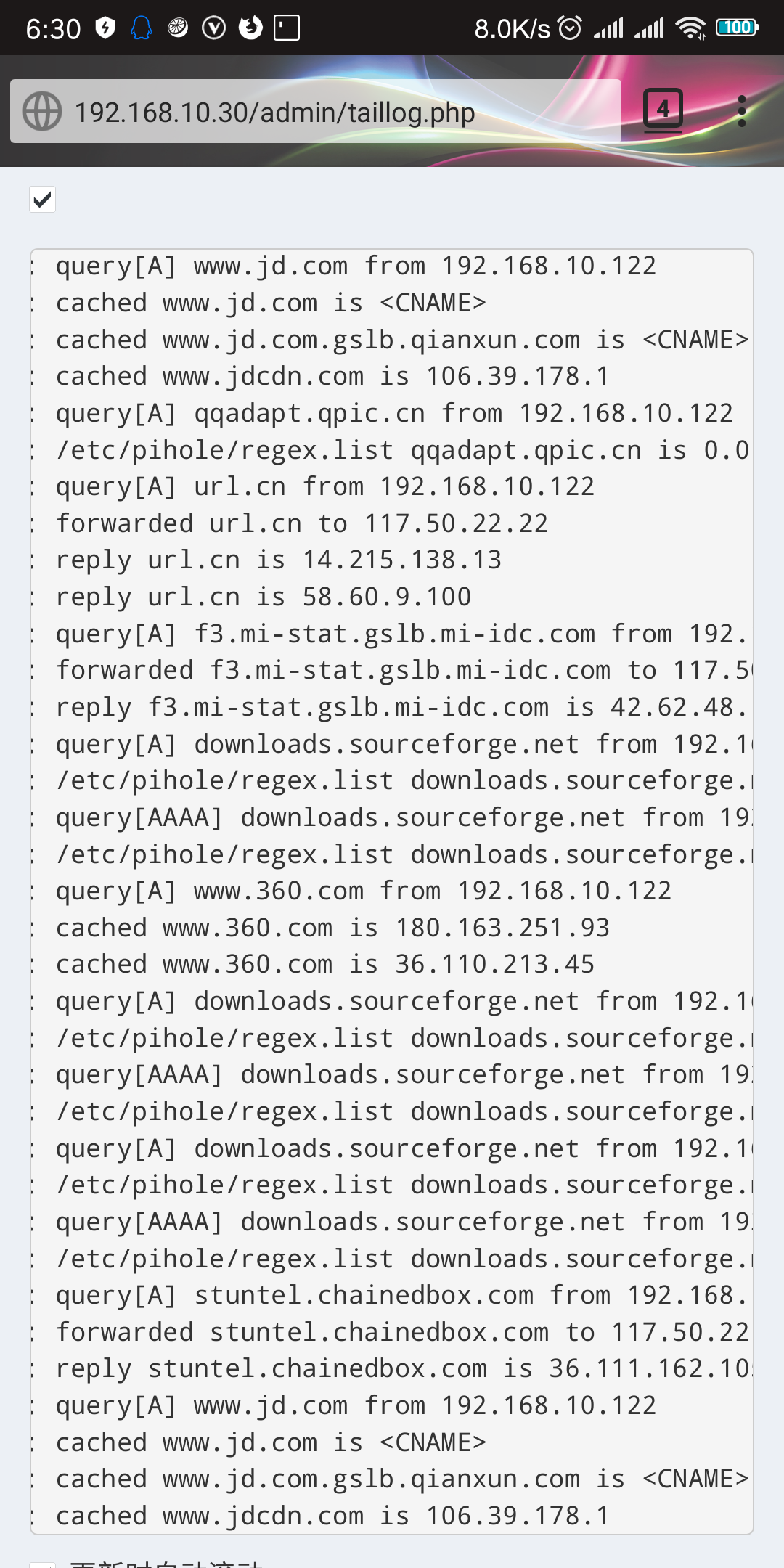

The tail logs shows me it has been blocked by regex list, but my regex and gravity list dosen't has that keywords. That's to say, when I lookup a domain contains "download" at will, it'll must be blocked, if there are over than two keywords.
Enable regex debug mode and you can see which regex filter is blocking which domain.

You have a regex for ad, download contains the letters ad and is blocked.
ok, I got that! Thank you for the help.
