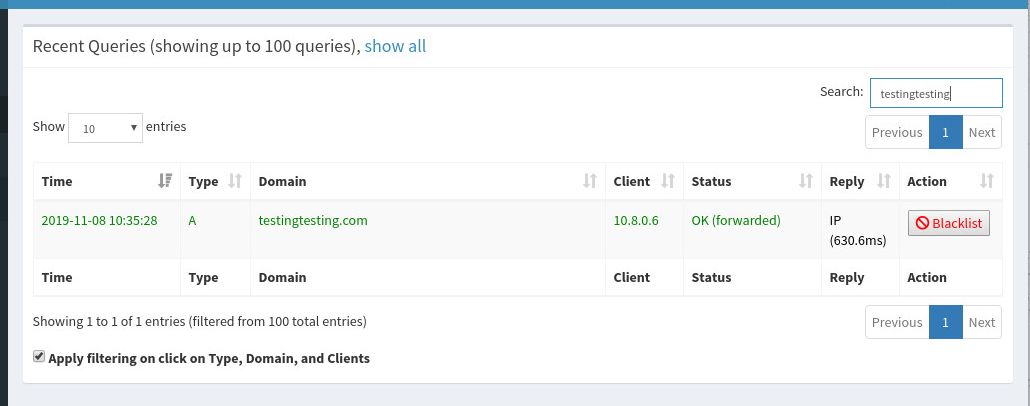

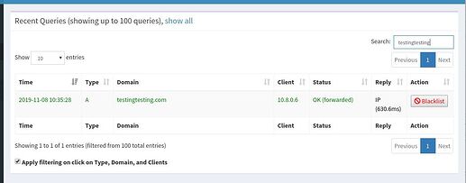

the requests to all servers are not showing up in the queries table as dnsmasq only accepts the fastest reply and drops the rest. I am showing 8 queries going outbound in the logs and a single reply, that single reply is what is then sent to client and reflected in my query log.
root@94ed689e0c35:~# grep testingtesting.com /var/log/pihole.log
Nov  8 10:35:28 dnsmasq[18893]: query[A] testingtesting.com from 10.8.0.6
Nov  8 10:35:28 dnsmasq[18893]: forwarded testingtesting.com to 127.0.0.1
Nov  8 10:35:28 dnsmasq[18893]: reply testingtesting.com is 91.195.240.126
Hopefully that answers your question? Let me know if you need any more info.
