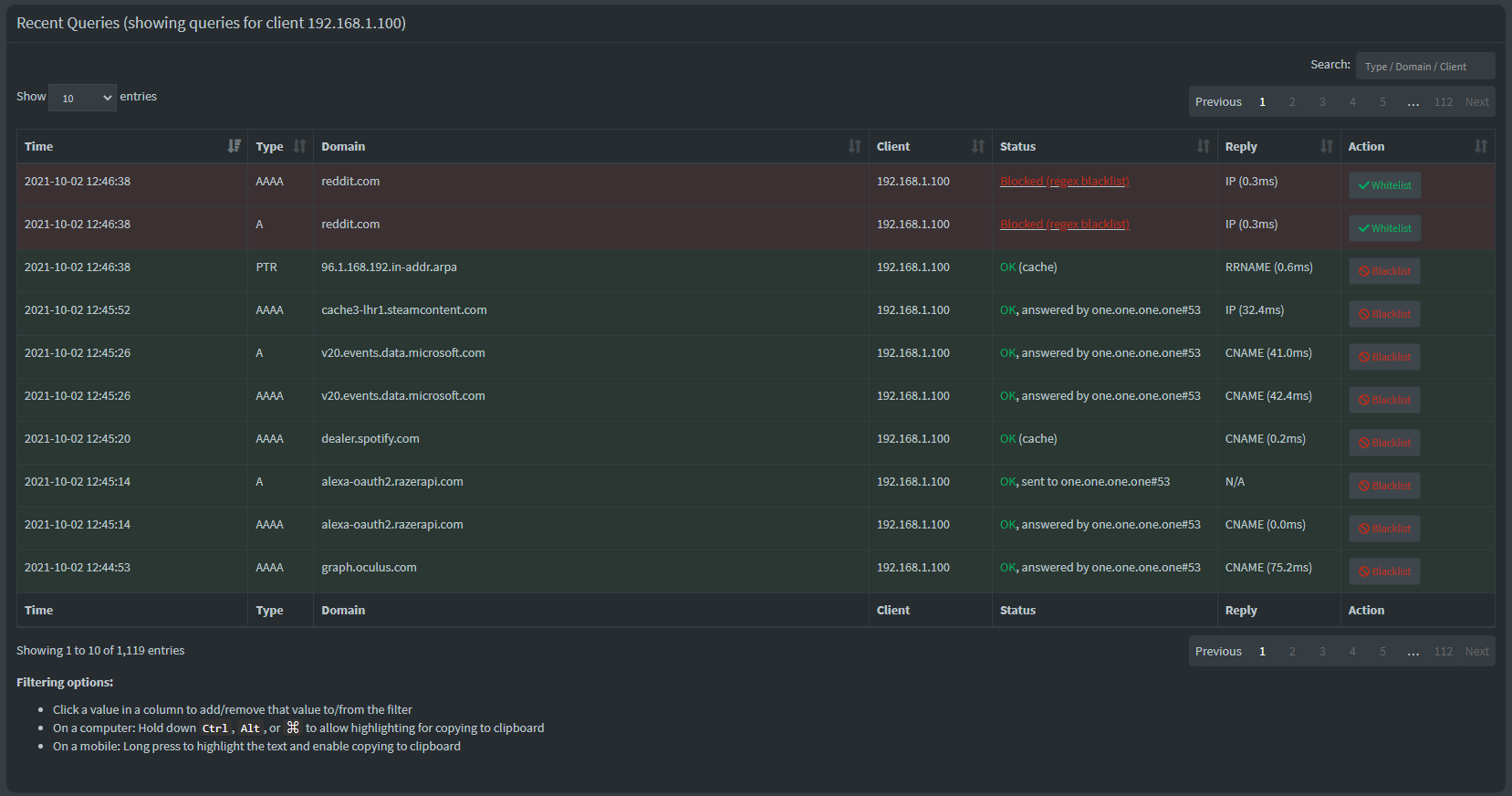

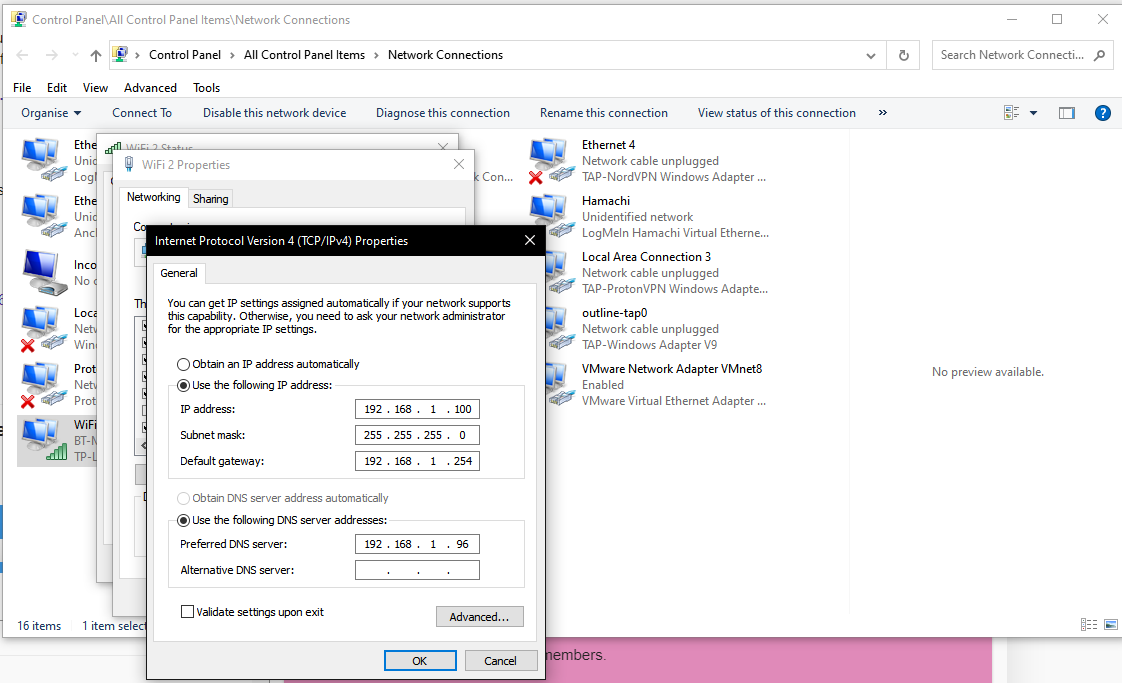

Maybe for some reason the PC is just not using the DNS it is set to. I've attached proof that it is set to the DNS server.
Also, when I load reddit once, it loads fine on my PC but says it was blocked on the Pi. It's definitely a problem with my PC because it works just fine on my phone.
