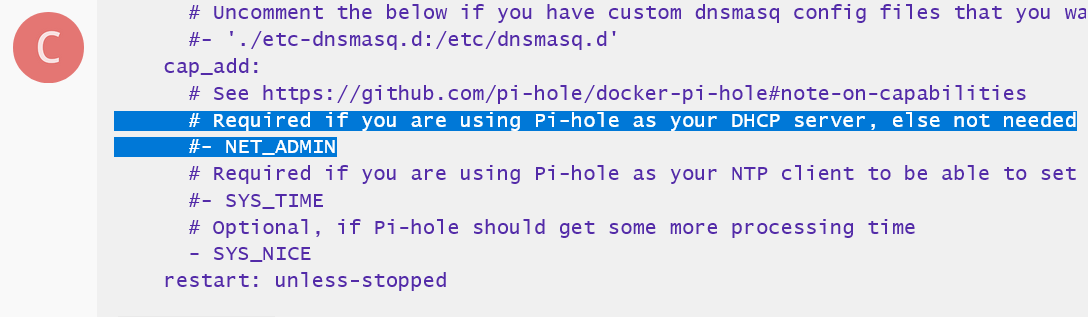

    cap_add:
      # See https://github.com/pi-hole/docker-pi-hole#note-on-capabilities
      # Required if you are using Pi-hole as your DHCP server, else not needed
      #- NET_ADMIN

FTL is not able to start the DHCP server:
2025-09-09 23:18:28.508 CEST [55M] CRIT: Error in dnsmasq configuration: process is missing required capability NET_ADMIN
You need to add NET_ADMIN capability to the container if you want to use DHCP.
Just uncomment the line on your compose file:
ffs, i am a freakin moron … thanks folks and apologies stealing your time, thath shouldn’t have slipped through :confused:
