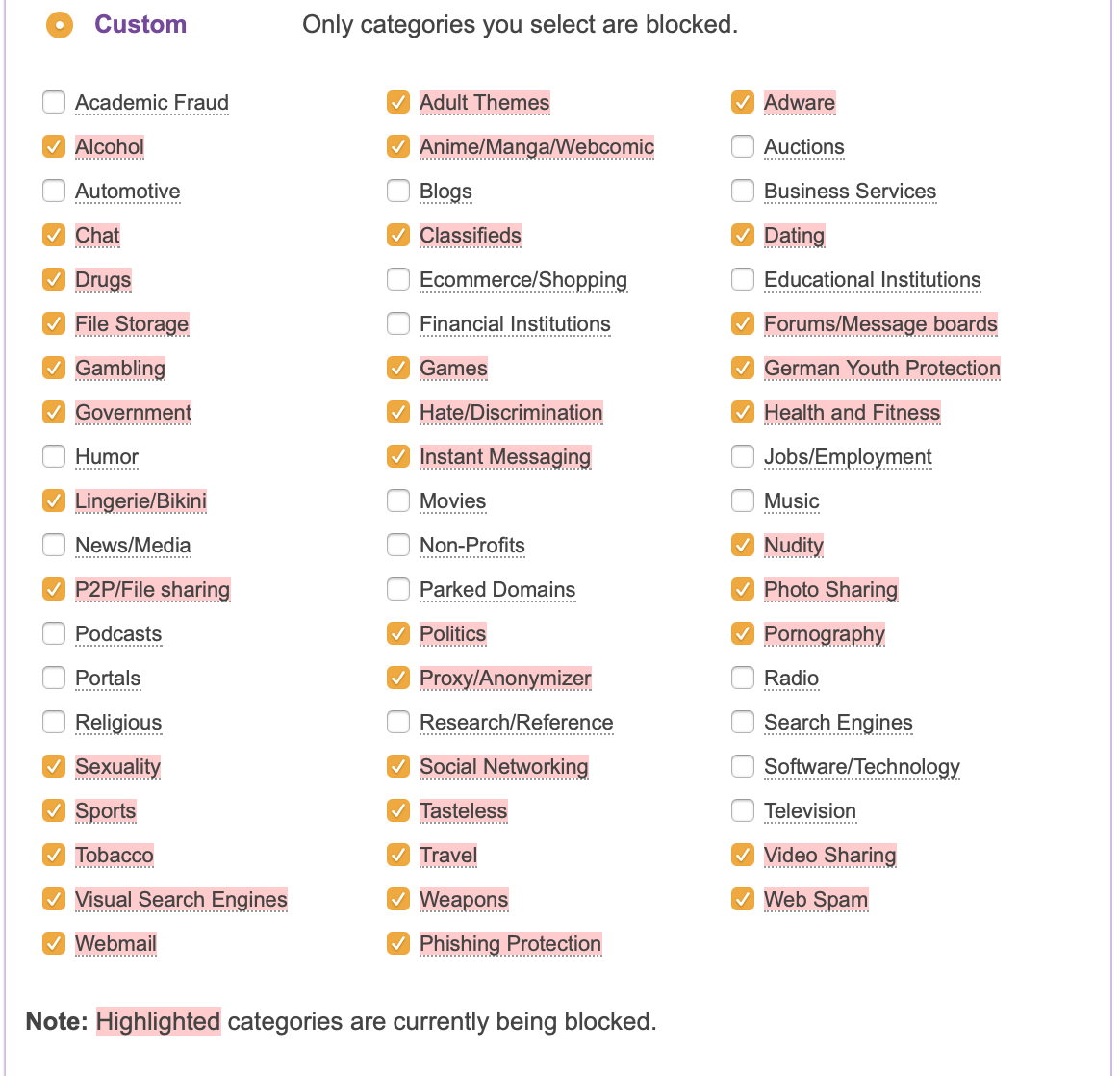

Currently things are working for ads filtering, but not as I would want to use as well my OpenDns account for content filtering like this...
so some devices in my network will have higher or lower filtering settings independently.... while all of them will be filtered through pihole ad blocking.
But when I do use my OpenDns Account to Activate Parental control... the pihole DNS in the Netgear Modem Router is replaced by both OpenDNS DNS... and ads goes through on devices...

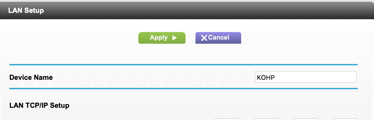

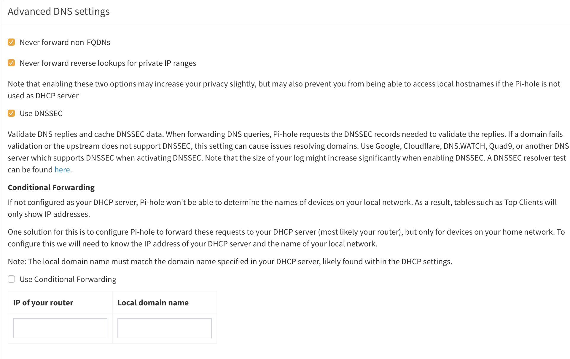

One more thing, is under Pihole Admin, if I do use only the first configuration stated above, and activate pihole, which value am I supposed to insert into "Local Domain Name" under conditional forwarding in the advance DNS settings?
I had tried "Localhost" because I could quite locate the LDN. Since Pihole notifies it must be the exact same... I'm not sure where and how to find it, cause does not seem to be where it should be informed.... ( IS IT THIS?)
