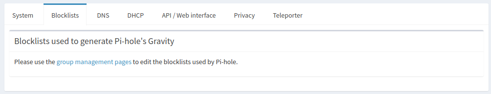

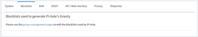

Blocklists can be removed altogether, if the network table is redesigned, DHCP lease management isn't needed, either.
Blocklists is already gone:

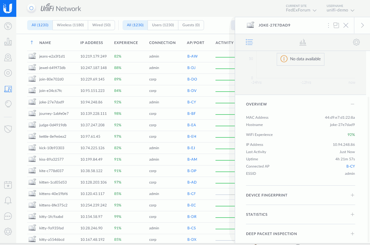

The comparison with Ubiquity
Ubiquity does some things differently than they usually do. A large collection of these can be found in the "UniFi Network Controller". There are in for Windows, Mac and Linux. I ask you to download the controller, install it on your desktop, and study. Software Downloads - Ubiquiti
My request applies in particular to the UNC client manager (/ manage / site / default / clients / 1/50). I had to think about it immediately when you wrote about a possible client manager for the Pi-Hole. You should really take a look at it and steal it for your pi-hole. This is exactly what you are looking for and makes the current DHCP lease solution for the Pi-Hole completely useless.

No need to download the UniFi Controller if you want to look at it. There is a n online demo:
https://demo.ui.com/manage/site/default/dashboard
Excellent! Thanks, I didn't know yet. :ok_hand: :muscle:
The easiest way to ...
https://demo.ui.com/manage/site/default/clients/1/50
... and click on one of the clients.
In the newly opened window, the first and the last folder are particularly interesting. The first folder shows that the client is recorded as a whole. In the last folder, the alias, the network membership and the static DHCP address can be set. The reason why I think that the current DHCP solution from the Pi-Hole could also be organized differently.
Network affiliation: In your case, this could be the domain. But could also offer a multi-network (multiple IP ranges) DHCP. Without routing NAT and all that, all just DHCP.
Ubiquiti differs from itself? How?
Are you perhaps referring to the difference between their Edge and Unifi product lines?
Why would that matter here?
Pi-hole is open to inspirations, but we would not steal from others (like Ubiquiti is scrutinised for doing with GPL code).
I am appaled you are suggesting such a thing.
I cannot click on a client as such, but rather on different columns of a row that represents a client, resulting in different UI reactions when clicking on e.g. name, ap/port or uptime.
None of them brings up the folders you mention, the closest resemblance to your description being a click on name.
Specifically, I do see some client data, but not any of the alias, network membership or static DHCP address you mention, and I cannot edit anything:
So maybe the UniFi Network Controller you mention is different from UniFi Controller?
Also, UC is able to accumulate its data through actively communicating with equipment that allows to query that kind of data, i.e. Unifi products.
The same level of detail is not available if you were to use APs, switches or routers of different brands, which is a lot more like the situation Pi-hole has to cope with.
