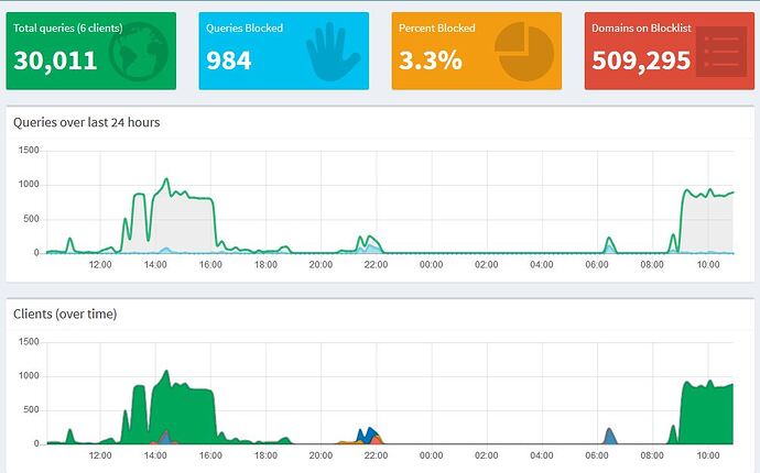

Today, I realise when connected with my PC's browser to the PiHole admin GUI that my PC generates loads of requests towards the PiHole server machine, which seem to be abnormally high as depicted with:
These findings are best depicted with green coloured graph that represents as client my PC and shows up with above 800 queries. All other clients in my local network are below 100 queries. The "total queries" counter is just counting up with nearly every second.

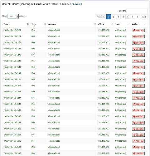

The history of high number of queries is best represented with the detailled log as depicted with:
Note: The server "dnsbox.local" is the PiHole server for which the PC in question is connected to through the web browser.

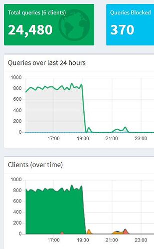

The next picture illustrades the situation of "high peak of queries when connected to PiHole server with browser" even better:
