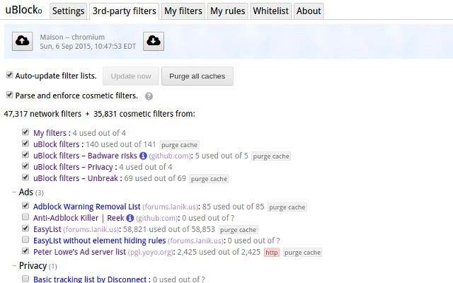

Unlock Origin had a neat feature to let you know if a particular source is updated or outdated, with time stamp, number of domains it is blocking.

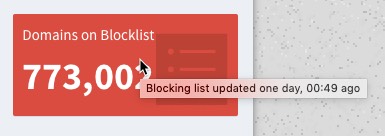

You can also mouse over the "Domains on Blocklist" box at top right of the Pi-Hole dashboard and it will tell you the elapsed time since gravity was updated. If this was done manually, the update log was shown at that time on the screen.

As much as I like uBlock Origin:
Identifying a list as being critical is not possible from the information on uBlock Origin's Filter lists pane.
An expression like '140 used out of 141' does not mean that 140 of 141 entries have been encountered and blocked. It just means that uBlock Origin discarded 1 entry from that list as a duplicate that it already found in some other list (much like Pi-hole does when compacting its gravity list to unique domains).
Qouted from uBlock Origin's official documentation on Filter lists:
uBlock Origin discards duplicate filters, so the number of filters used within a filter list depends on how many duplicate filters were detected within that filter list. The order in which the filter lists are loaded into memory is undefined.
