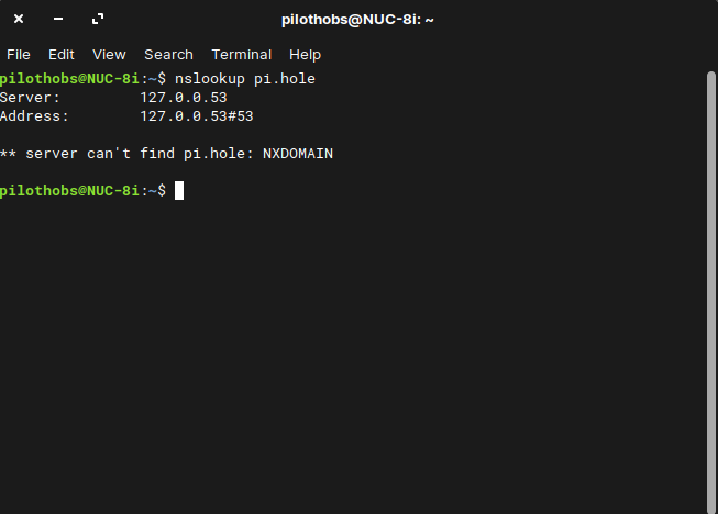

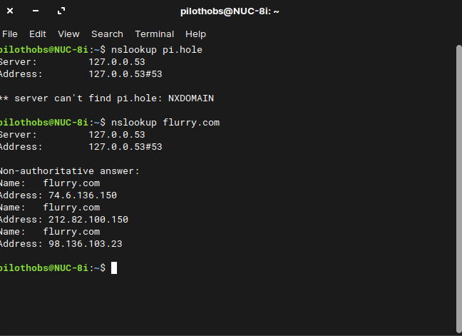

Run from a client that you expect to use Pi-hole for DNS, what's the output of:
nslookup pi.hole
nslookup flurry.com

Here is the output.
Hobs
Just a note:
When you post command line output is preferable to use text instead of images.
Text is searchable and easier to copy and paste if needed.

pilothobs@NUC-8i:~$ nslookup pi.hole
Server:		127.0.0.53
Address:	127.0.0.53#53
** server can't find pi.hole: NXDOMAIN
pilothobs@NUC-8i:~$ nslookup flurry.com
Server:		127.0.0.53
Non-authoritative answer:
Address: 212.82.100.150
Address: 74.6.136.150
Address: 98.136.103.23

Your nslookup results show that the machine you run those from doesn't use Pi-hole for DNS, but rather a local stub resolver at 127.0.0.53.
That stub resolver also doesn't forward DNS requests to Pi-hole upstream, or else it would have returned your Pi-hole's IP instead of NXDOMAIN.
But judging by your prompt (pilothobs@NUC-8i), it would seem you ran those nslookups from your Pi-hole host, when I asked you to run them from a client.
If that's indeed your Pi-hole host, then its DNS resolution would be irrelevant for Pi-hole's DNS operation. It would be ok and can even be of advantage that Pi-hole's host would be using a public DNS server.
