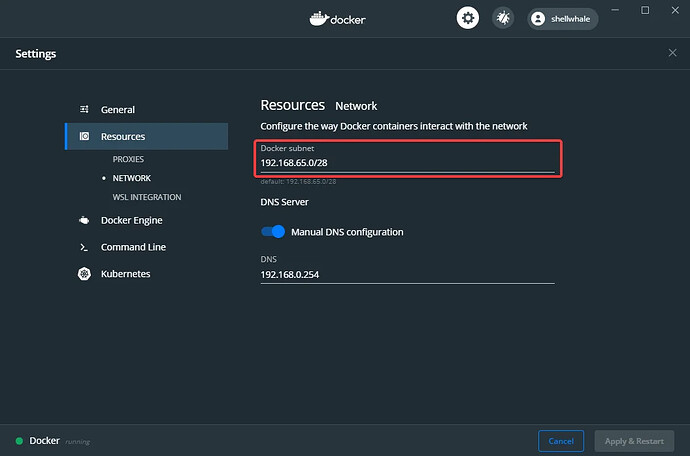

This the what I set it to (my real config for the network)
Even when starting it with host and a modded file it still spits out this error.
(I set the GUI to port 80)
You shouldn't change this range to the same range you use to your network.
You need to fix the network use by your container.

You don't need to change the docker desktop subnet range. You need to fix your compose file or docker run command to use the correct IP.
