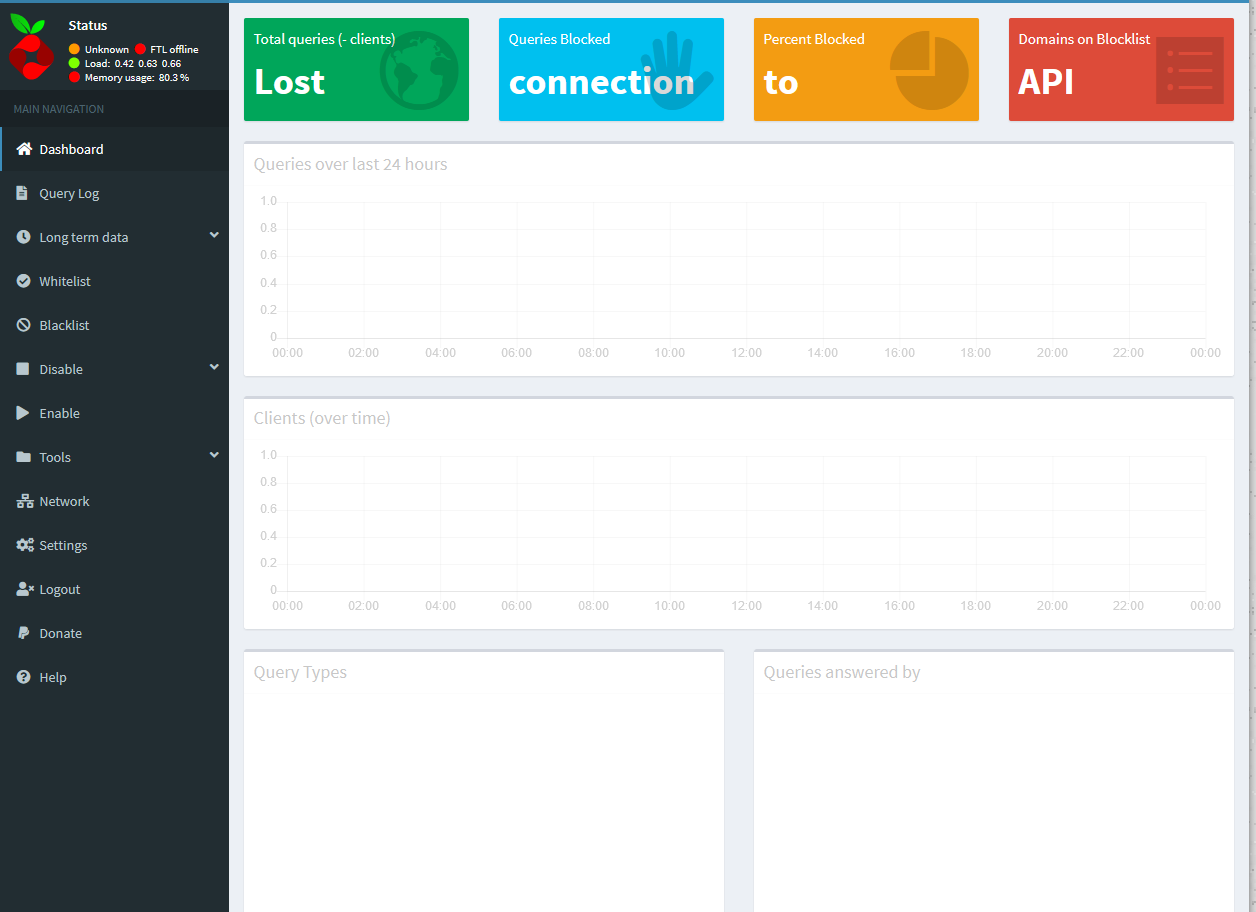

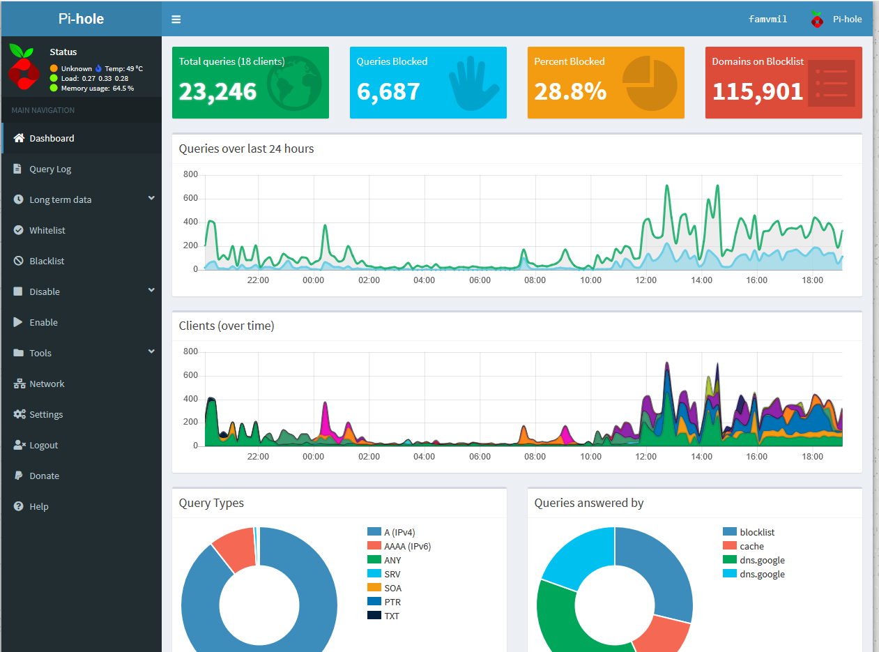

status as Running and FTL Online. Youtube ad Blocking
unknown status and FTL offline. Youtube ad plays

okay. i can live with that still. but why are my status off and my API lost connection?
This indicates that pihole-FTL is likely not running. What is the output of the following commands from the Pi terminal:
sudo service pihole-FTL status
sudo netstat -nltup | grep 'Proto\|:53 \|:5053 \|:5353 \|:8953 \|:67 \|:80 \|:471'

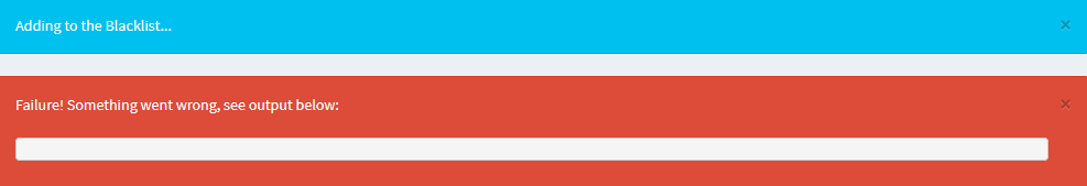

also when i try and blacklist a URL this error will pop up.
I believe this is your problem

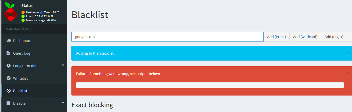

Hey! it have turned it off now. And its working! however the status is still on unknown...
and black listing still doesnt work

You are running Apache2 web server on port 80, which is interfering with the Pi-Hole web server (lighttpd). You will need either to uninstall Apache2, or move either Apache or lighttpd to a different port so they don't conflict with each other.
