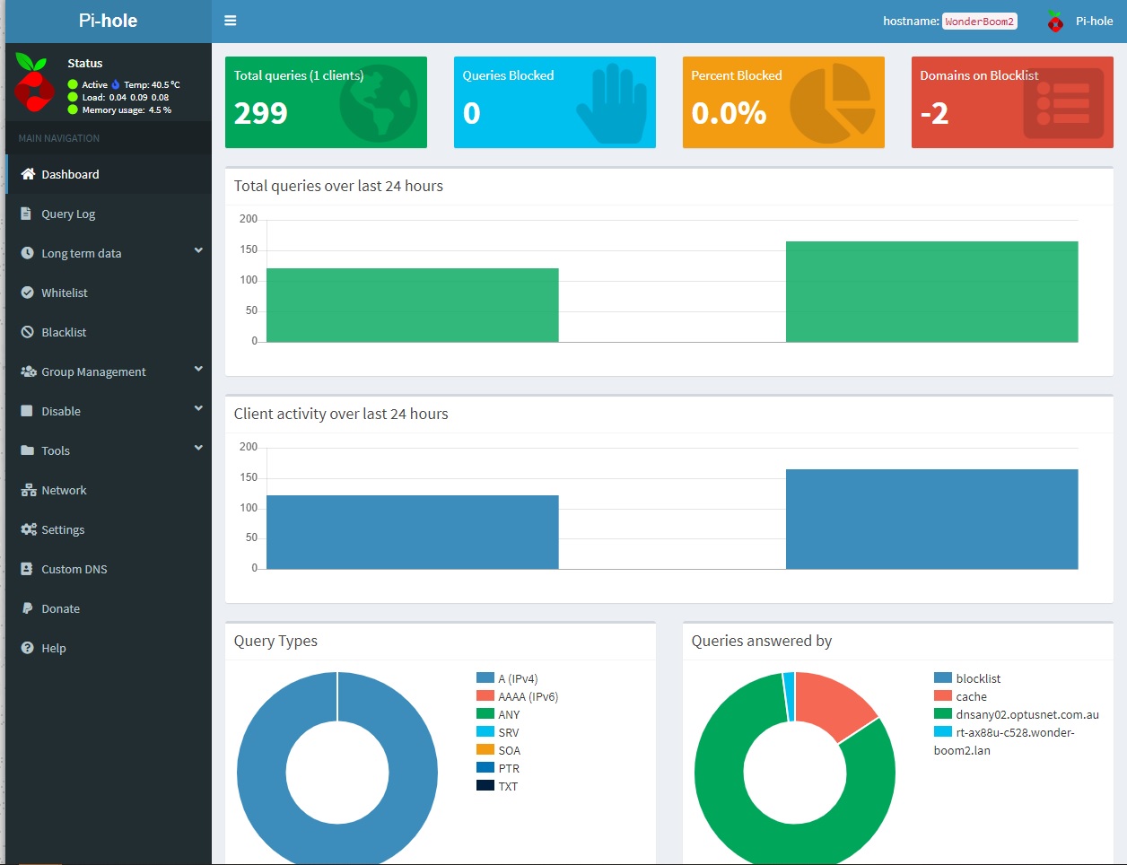

Web interface updated, i can see a difference now, i still have a -2 on domains on block list, but i purged all the dead lists that i suspect are causing the issue

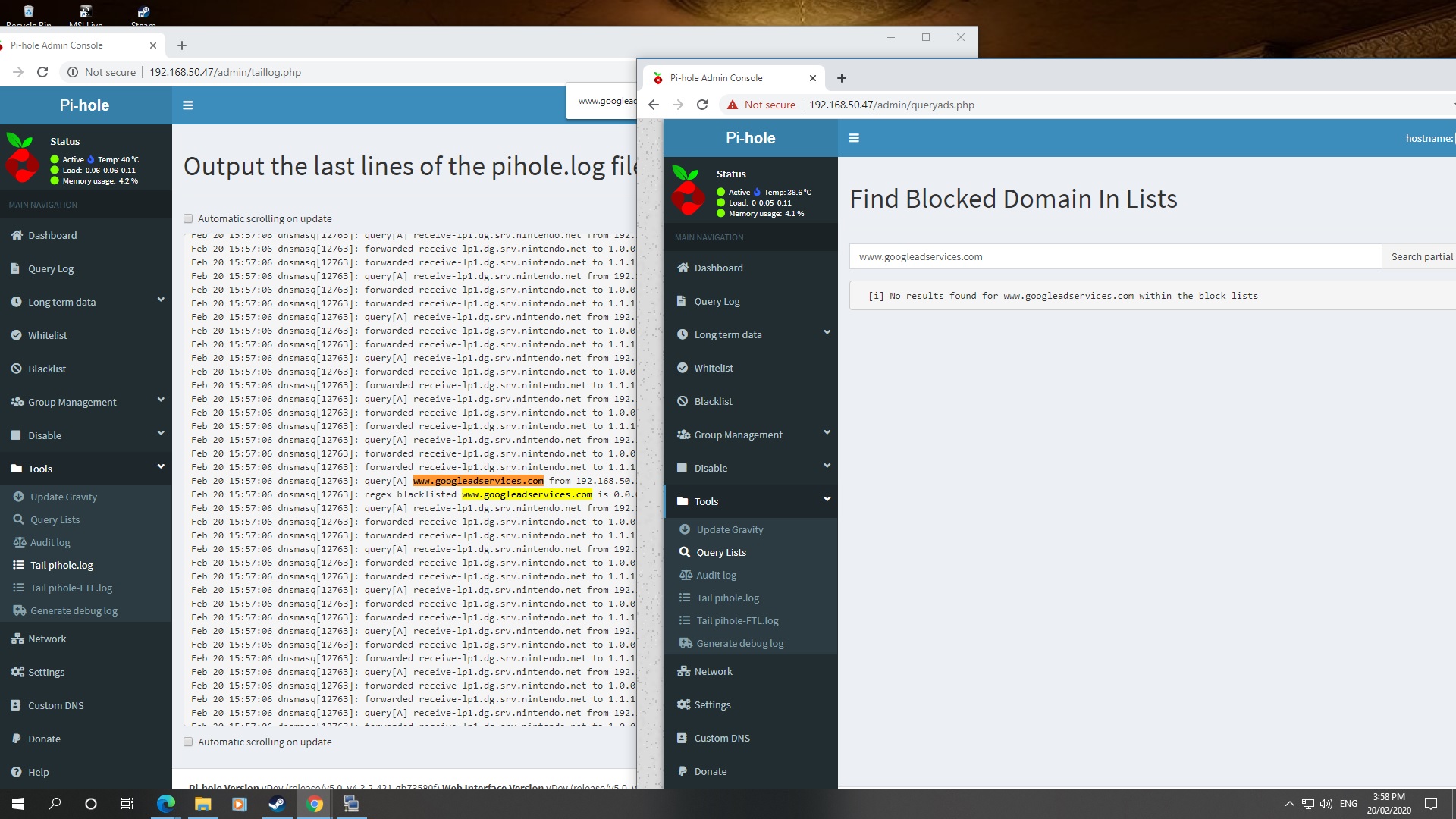

Also the read only database is back, GUI is not updating with blocked domains, and there is no entry's in the live log for blocked domains.
ive check the live logs and its not blocking them at all.
i believe the issue with read only and gravity are the same issue, it cant write the gravity to the db and its having a fit.
i fixed one list that was github.com not rawgithub.com
No blocked domains on GUI, blocking is not working for some reason seems to be letting ads pass through oddly.

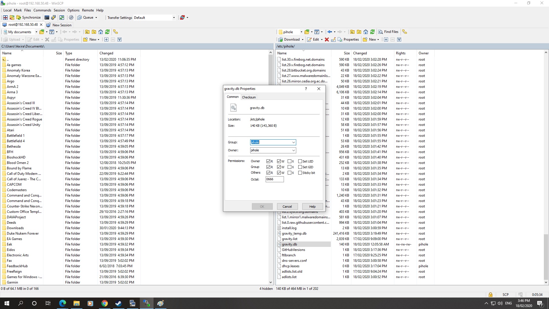

holy smokes i just worked out how to fix the issue there is a permission issue with gravity db, this fixes the web ui not accepting domains and also fixes my teleporter issue.
Also blocking is now working.
Still have a -2 on blacklist domains might need to let it settle, and the gravity issue is still there

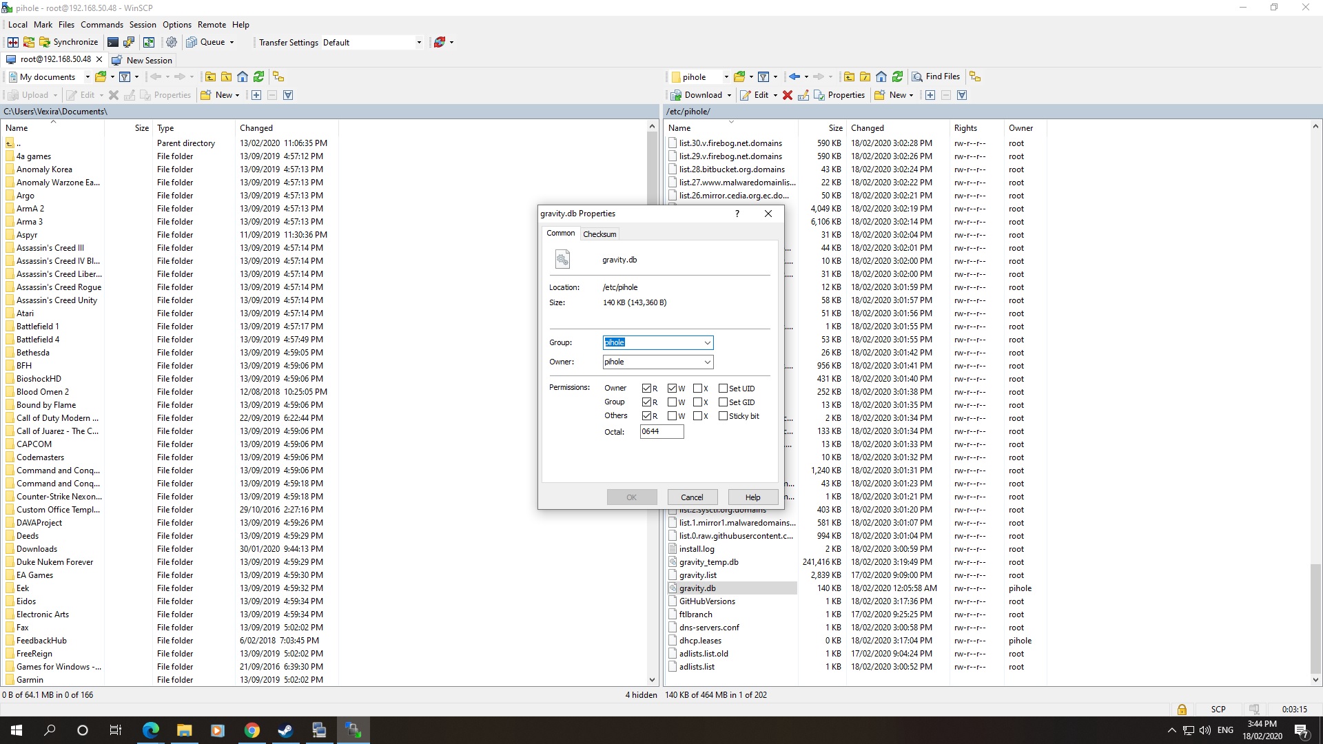

Default permissions- causes read only
Fixed persmissons
Also gravity temp db keeps changing its owner and group to root once i do a gravity after i set both to pi hole

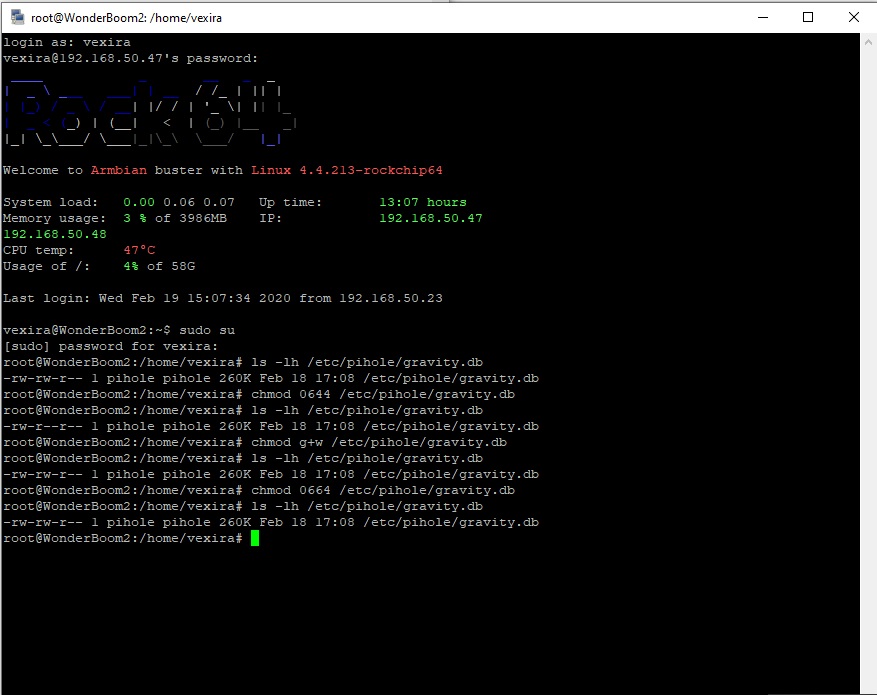

This permission is indeed incorrect, however, why are only you seeing this?
This part of the code should add group write access at the end of the pihole -g run:
Please also check with 0664 (no write for Others).
I'm not entirely sure but my, assumption is that it's because I'm the only person using a rock 64 with armbian buster, I have ordered a pi 4 pre maturely, since I suspect the gravity issue is related to the permissions problem, I noticed that alot of the files in the etc pihole are set to root and not pihole for some strange reason even in opt pihole, is that normal?
I noticed that running gravity was reverting permissions in the FTL db when I changed them.
Yes, only gravity.db and the folder itself needs to be group writable. For the rest, group readability suffices.
Yeah, this is somewhat expected. However, they should be set to 0664, in your screenshot above they were 0644. To what do they get reset?
Please also try the following experiment:
ls -lh /etc/pihole/gravity.db
sudo chmod 0644 /etc/pihole/gravity.db
sudo chmod g+w /etc/pihole/gravity.db
sudo chmod 0664 /etc/pihole/gravity.db
What is the exact output of this chain of commands?
reset to deffault permissions and root instead of pihole.
