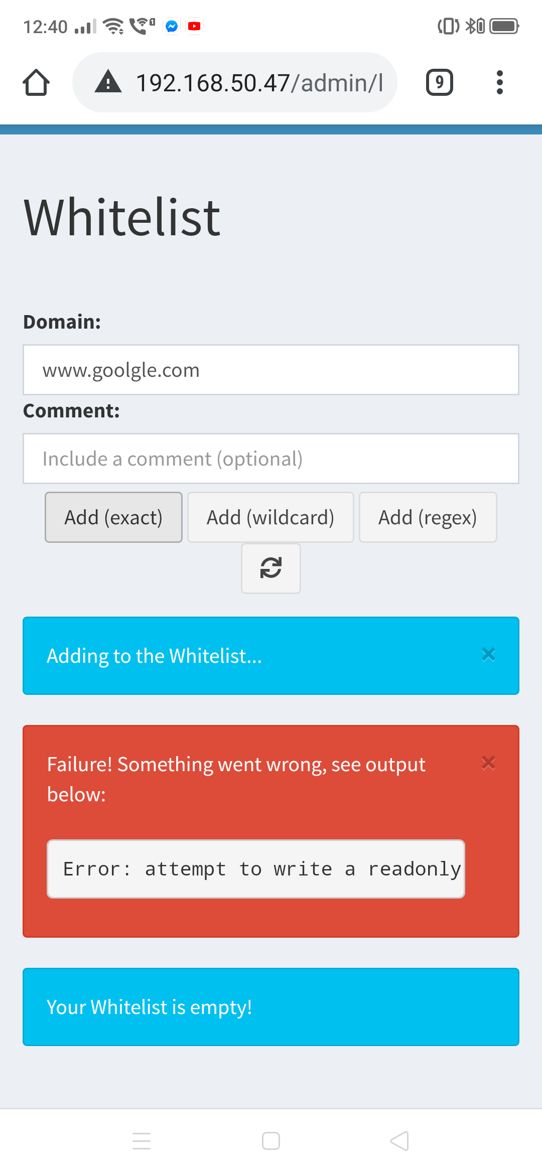

A Few issues with the beta on a fresh install

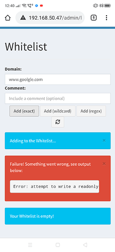

From mobile screen shot, chrome browser.
Okay, it is still a bit confusing, so the -2 on the number of blocked domains is gone and replaced by the correct number, but the rest is still not working (guessing from your photo of your screen).
No, the number of blocking domains is mostly irrelevant and we're commonly seeing that Pi-hole works with such large numbers even on low-end hardware.

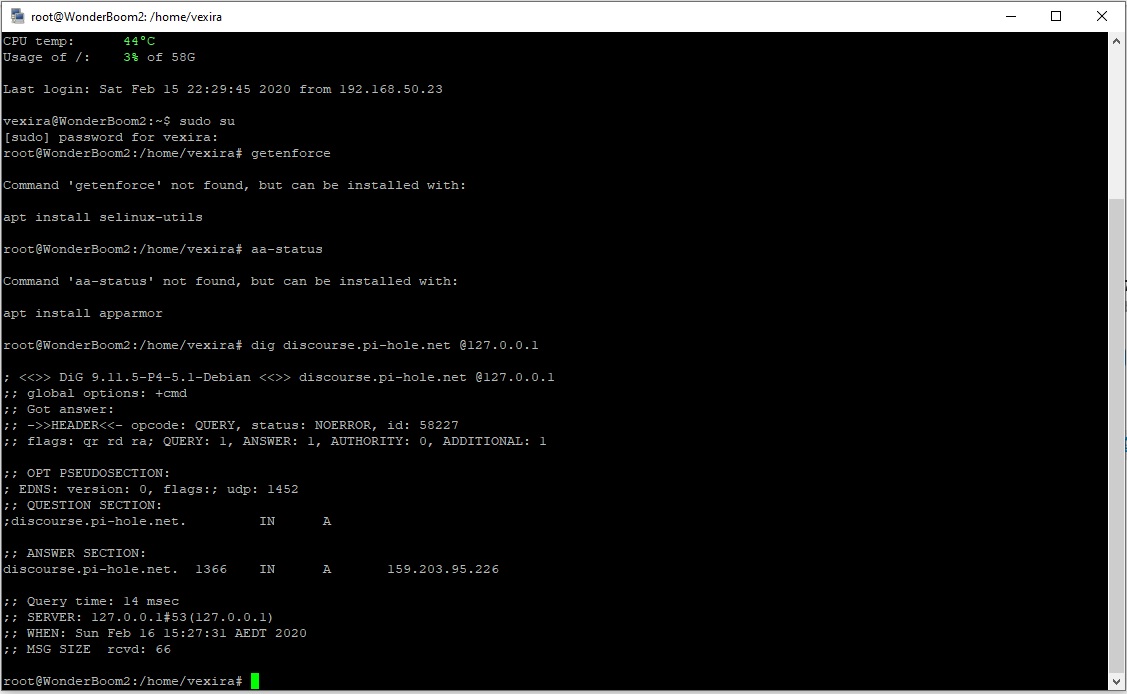

What is the output of
sudo getenforce
sudo aa-status
? This will check SELinux and AppArmor. If any error pops up, this may be okay as that might just show that this respective thing is not even installed.

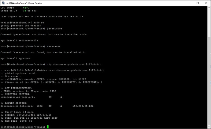

Did you point any device at the Pi-hole? If not, please perform a few queries on the device locally, e.g. using
dig discourse.pi-hole.net @127.0.0.1

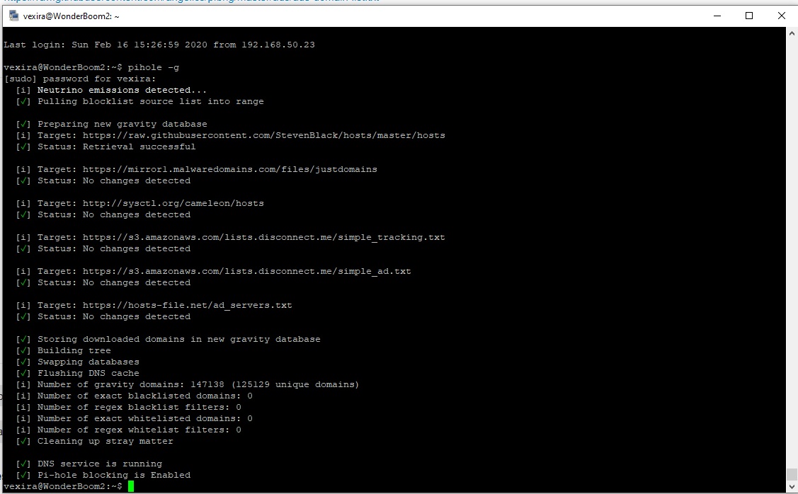

The photos is from the 4.0 installation before I updated to 5.0 after I updated to 5 I lost a few domains due to the gravity error.

Okay, so next question is: What is the output of

Results for dig and se linux

First try reducing the lists to the first few:
to check if this restores the basic Pi-hole functionality. Then, we know where to go forward.
You do not need to delete the others, you can simply disable them.
well that fixes the error with gravity
Some of those lists aren't in pihole format - probably choking somewhere.
Odd pihole 4 has no issues with the lists seems that it's an issue in 5 with SQL having issues.
Yes, Pi-hole v4.0 accepted invalid domains to some degree (containing quotation marks, etc.). It'd be enormously helpful if you could find out which of these domains is causing the issue. We can then adjust the domains parser to work with them.
Let me be honest: Getting Pi-hole to work isn't highest priority with all the other beta things going on. However, if you can help us identify which list is the culprit, I promise to make the necessary adjustments to let gravity run through. I'll look at some of them but given the large number, it is unlikely that I'll find it by just cherry-picking random domains.
I'll check my main concern is to fix the database locking error that is preventing me for using the GUI, gravity is secondary also thank you for the help I greatly appreciate it, I'm considering wiping it and seeing if it work or if all else fails just buy a pi 4.
So is this still present with the reduced set of lists? It could have been due to the gravity errors before. We've already checked all the permissions for the web user, the database folder and file and they all seemed file so there should be nothing left causing this.
gravity parsing error is gone but the database is still locked, ill have to look at the lists to see which have issues being parsed.
i might have to nuke it again see if it works this time, only issue i can see is that all the domains are 0 on gravity.
ps aux | grep sqlite3
The only thing that could be causing this when all the permissions are fine may be a still running sqlite3 transaction, not sure how to resolve this.
You could also try a selective nuke option:
rm /etc/pihole/gravity.db
pihole -g -r
but please ensure first that /etc/pihole/migration_backup/adlists.list (path may actually be slightly different) does contain only the few domains you've seen Pi-hole working correctly with.
vexira@WonderBoom2:~$ ps aux | grep sqlite3
vexira 4859 0.0 0.0 5820 664 pts/0 S+ 20:40 0:00 grep sqlite3
Okay, so no running gravity process. I really hope that the restored/newly created database will fix this issue for you.
