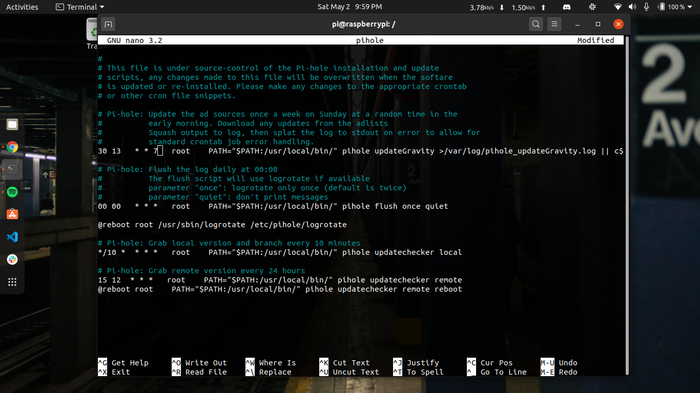

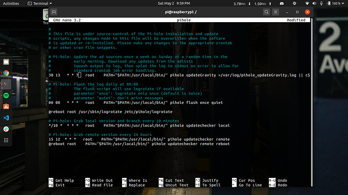

How can i edit the time ?? Because my internet is not 24/7 turned on
You can manually edit this file and change the parameters. Note that your local changes will be overwritten on a Pi-hole update or repair.
sudo nano /etc/cron.d/pihole
As noted in that file, there are other locations where you can place cron scripts that will not be overwritten by Pi-hole.
https://www.raspberrypi.org/documentation/linux/usage/cron.md
if i put the time only and put * on the 7 does that mean it will update all 7 days
