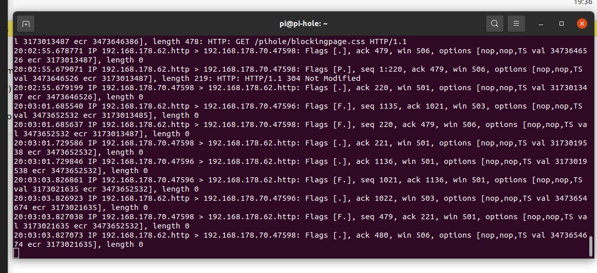

I have now used tcp dump to see what goes down with the pihole.
If I access 192.168.178.62, the pi hole replies to 192.168.178.70, which is ok.

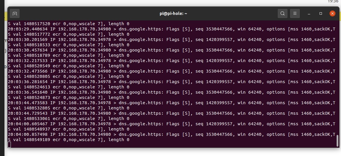

If I access 8.8.8.8 the pi-hole sees that. rejects it because it is not for him. there are no answers. The static routes are normal for another router and he now knows where to forward it. but the pi-hole cannot do with packages for 8.8.8.8.
can i teach him that?

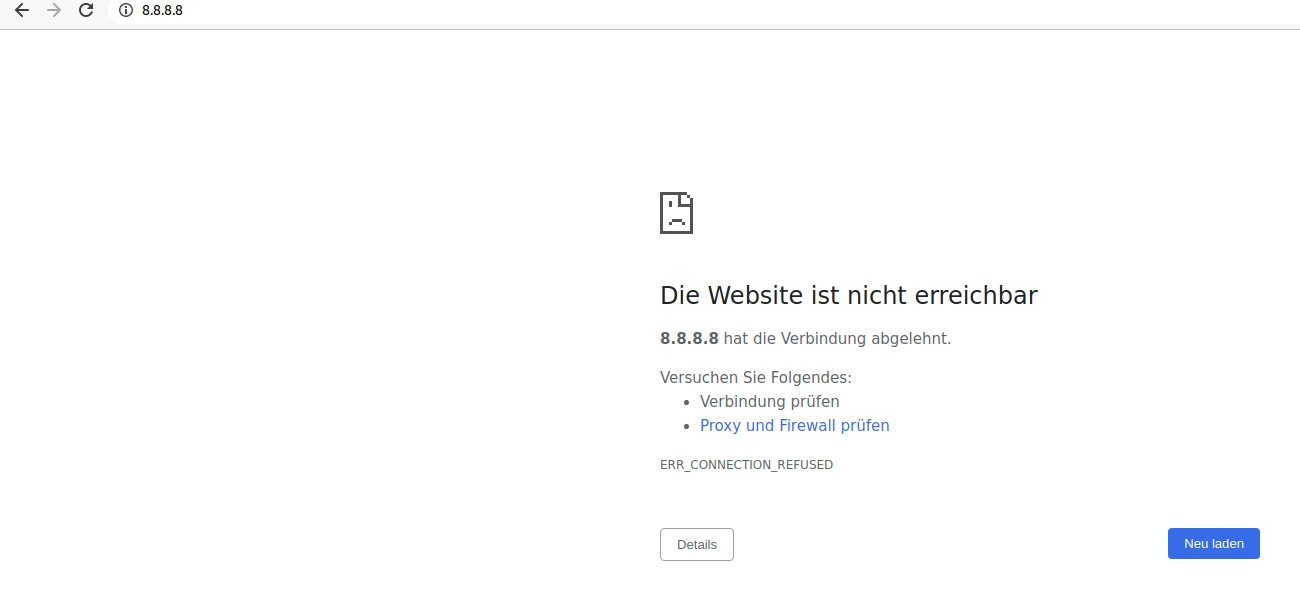

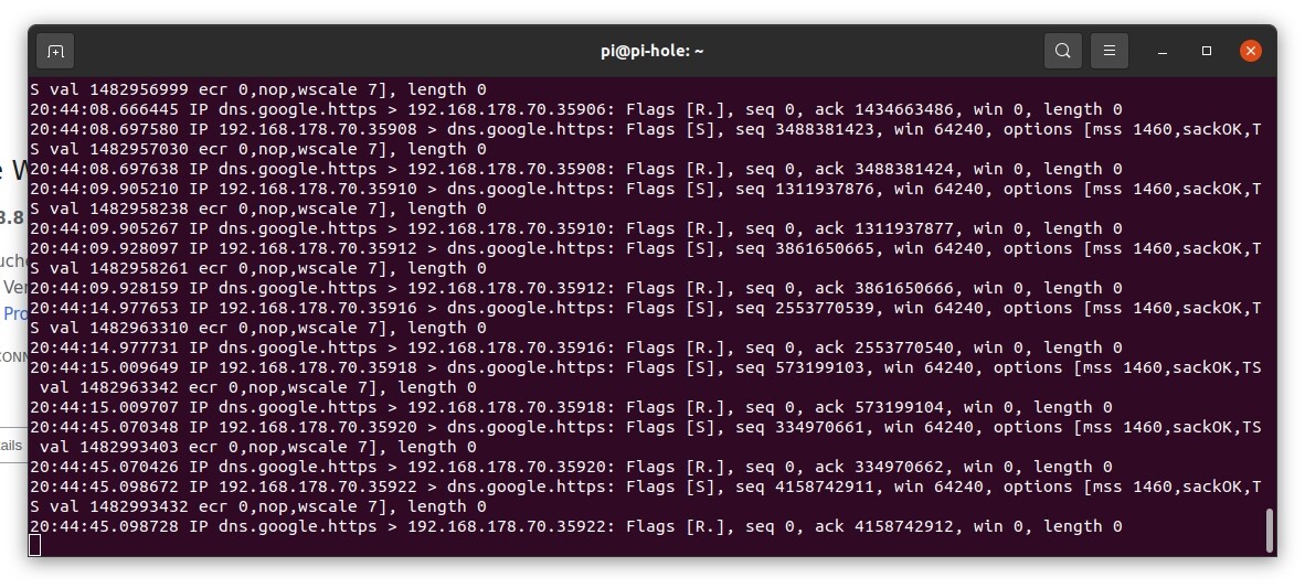

ok, with ** sudo ip addr add 8.8.8.8/24 dev eth0 ** I was able to assign 8.8.8.8 to the pi hole. he answers now. anyway i don't get the side of the pi hole. I have to test whether that works with DNS inquiries.
yeah, it works.
pi hole answers on 8.8.8.8:53 also on 8.8.8.8:80 but not on 8.8.8.8:443 https. Presumably it fails because of the encryption.
