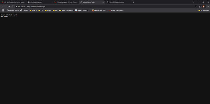

This is not the Pi-hole 404 page.
It should look like this:
Looks like another web server is answering the request.
Are you sure you are connecting to the same network Pi-hole is installed?or are you using a VPN and another service is answering the request?

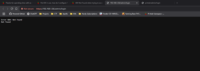

What do you see if you try accessing using https?
Also, please generate a new debug log.
I see this - same thing:
New Debug log:
https://tricorder.pi-hole.net/A03jBjK9/
OK.
I found a very unusual way to replicate your screenshot.
Error 404: Not Found
Not found
If I move most of the files from /var/www/html/admin to a different place, the web server will show the same error message, but this is not a normal circumstance.
