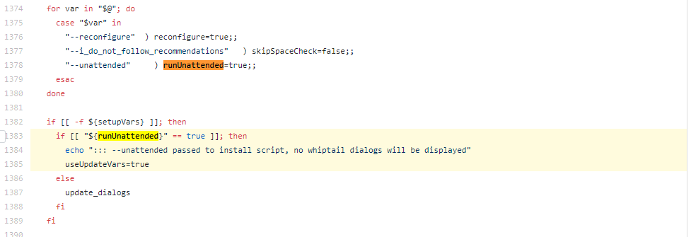

The additional repo(s) need to be cloned here, but when the --unattended option is passed the variable useUpdateVars is made false and in line 1412 it gets decided that the repos don't need cloning.
Unfortunately.

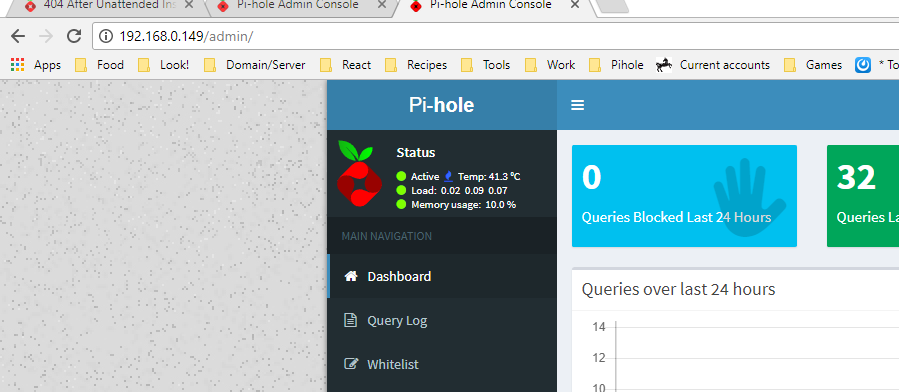

Have you tried accessing the http://<pihole-ip>/admin from a browser near you?
::: Checking for existing repository...
:::    Cloning https://github.com/pi-hole/AdminLTE.git into /var/www/html/admin... done!
:flushed:
But line 1435 is skipped.
What is your definition of a "fresh Pi" then? Did it have lighttpd pre-installed?
Freshly flashed SD card, sudo raspi-config run to expand the filesystem, and not a lot else. Maybe an apt-get update && apt-get upgrade chucked in there for good measure.
If useUpdateVars is true (as it is in this case) it will hit L1450 instead.
