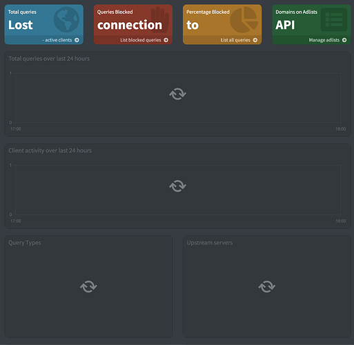

Now I am encountering this screen where it seems there is no connection to the API. I am currently looking into this.

I cloned and executed the script in the repo from the Reddit post I mentioned and now the console is properly displaying statistics.
To be honest, I do not completely understand what the properties these commands are modifying are nor do I know how policy modules work. However I do remember that one of the lighttpd errors I ran into before said to run setsebool -P httpd_setrlimit on, which is one of the commands on the shell script.
