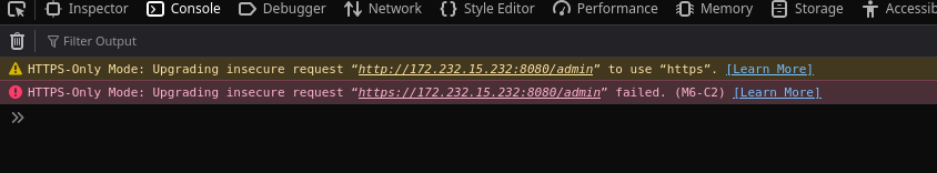

This is what I see when I go to both URLs.

Pi-hole web server is using ports 8080 (for http) and 8443 (for https).
Both links above should work, but your browser is forcing the use of https because it is configured to use HTTPS-Only connections.
Your image shows the issue.
When you try http with port 8080, the browser is "upgrading" to https, but it is using the wrong port.
https connections are not allowed on port 8080. You need to use the correct port.
Try https://172.232.15.232:8443/admin (pay attention to the port used after the colon).

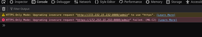

I see. I tried going to https://172.232.15.232:8443/admin, but it still hangs and doesn’t load. And the same error as before is showing again.
