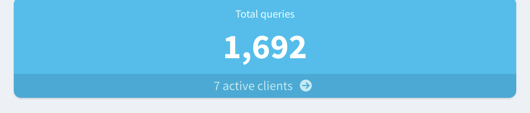

11 clients, but shows 7 active,

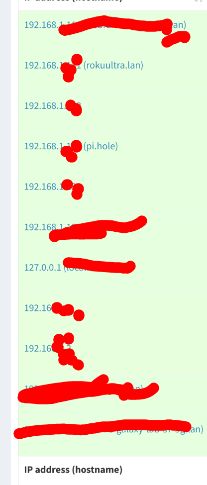

Your second image shows all 11 clients.
The Dashboard shows 7 clients because only these 7 clients used Pi-hole in the last 24h.
If a device doesn't use Pi-hole as DNS server, it won't be considered active.

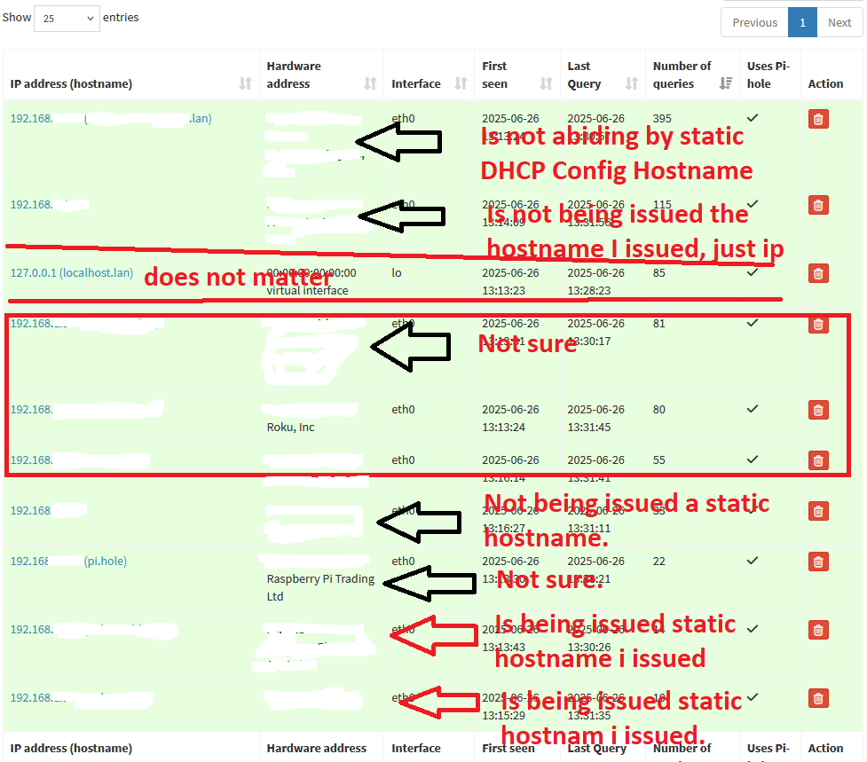

i issued a new static ip and name of a device and issued same specs of mac,ip,name and pihole is still not issuing its name under devices, just ip. but shows the device ip is using pihole.

also i wiped out Static DHCP configuration and left one device with example above, few devices are being detected by ip,name. i have 4 devices not being issued a static name configured correctly. i cleared dhcp table rebooted rpi4.

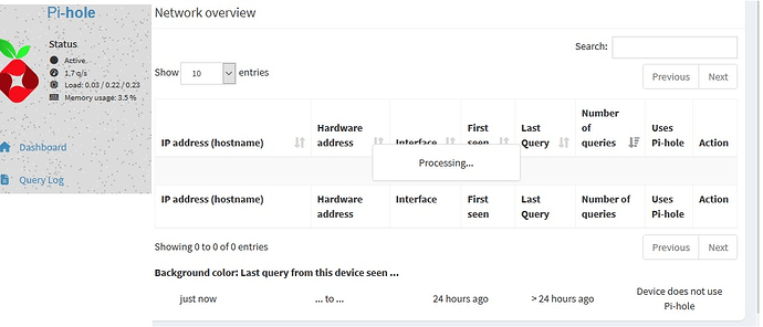

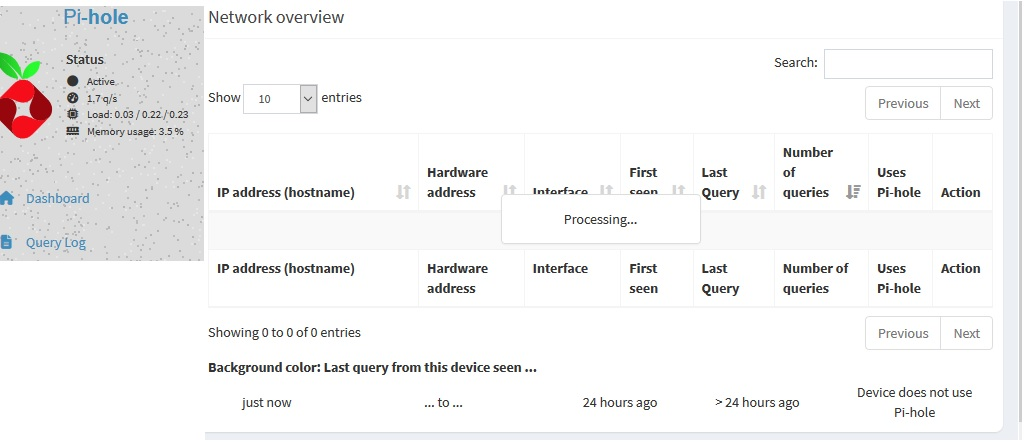

so i logged into pihole through ethernet pc. network table is blank n says processing.

I wonder how you managed to open Network overview when there's no menu entry for it?
That screenshot doesn't look like a current v6 installation?
It's missing labels and even whole sections in the left hand navigation tree.

Ok, i found out that static DHCP configuration is not working at all. Pihole-Unbound is reading the device names and issues the host name by device name and no matter if i edit static dhcp config to a different name, static dhcp config is not over riding the device names. i am confused.
So I ended up uninstalling pihole and unbound, reinstalled both, pihole latest that the bash install cmd installs. All is gravy now:slightly_smiling_face:. all clients are being issued custom host static name. I don't know where/when/how dev build git broke on my end.
