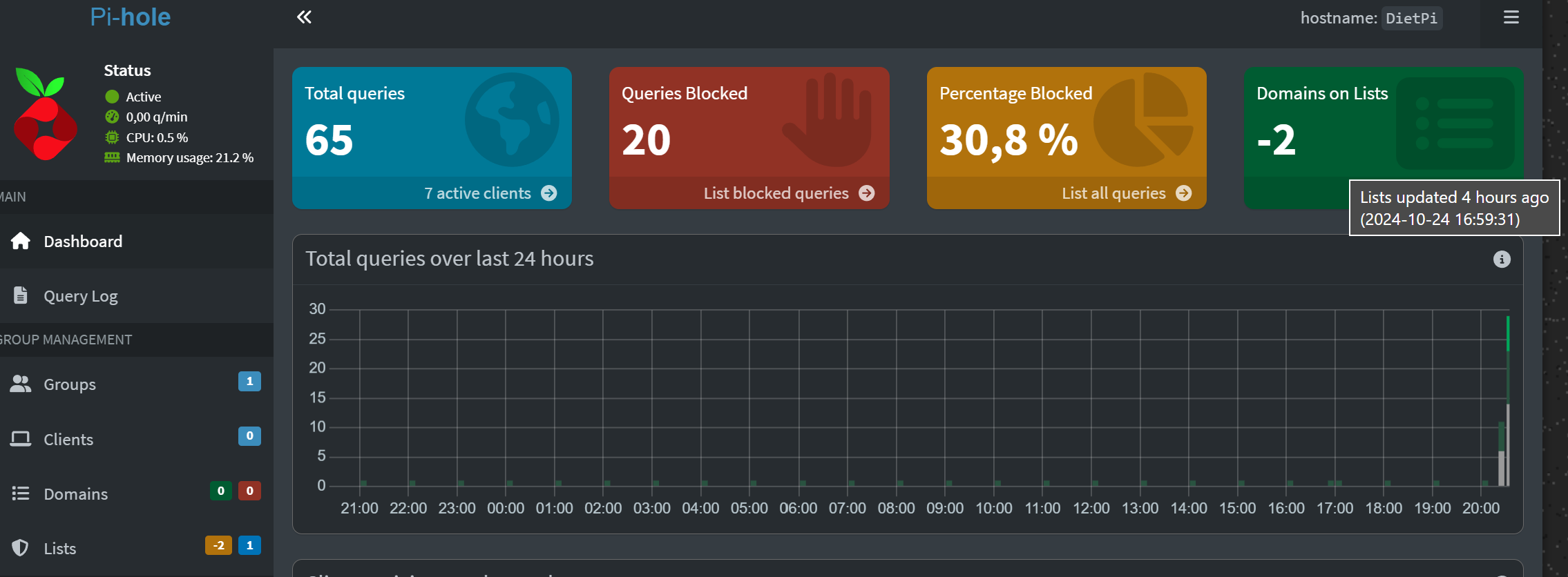

-2 Domains on Blocklist (after updating pihole)

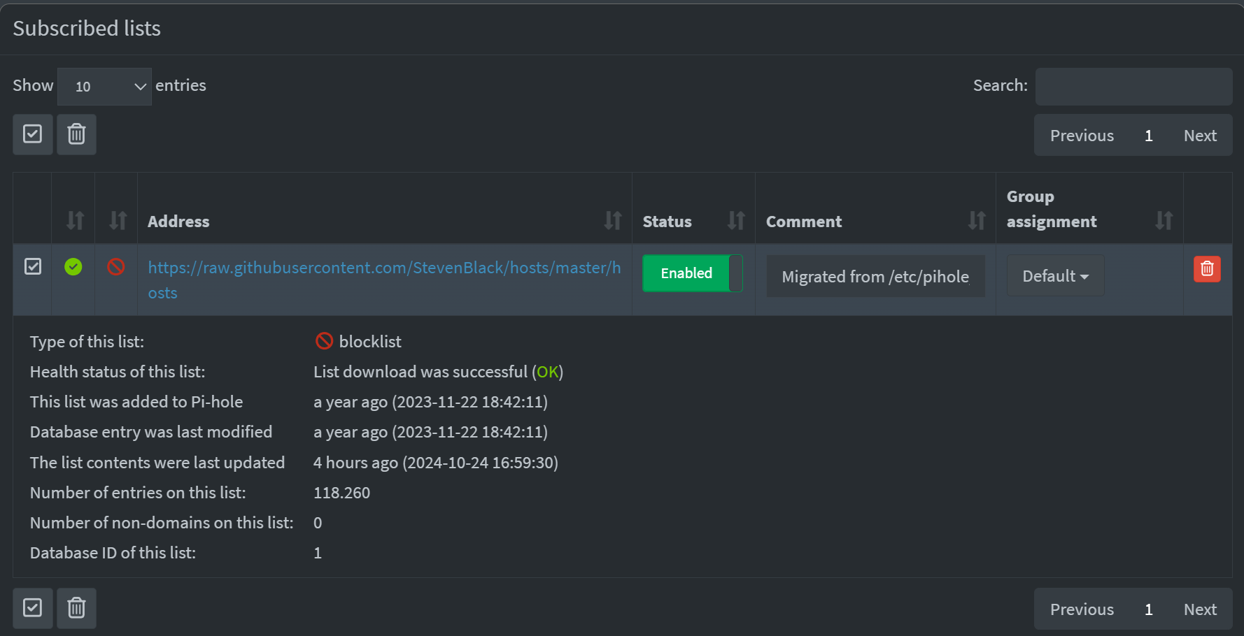

Sometimes the dashboard just shows -2 domains on the blocklist.
Nevertheless, the blocklist seems to be active, because blocking works as expected.

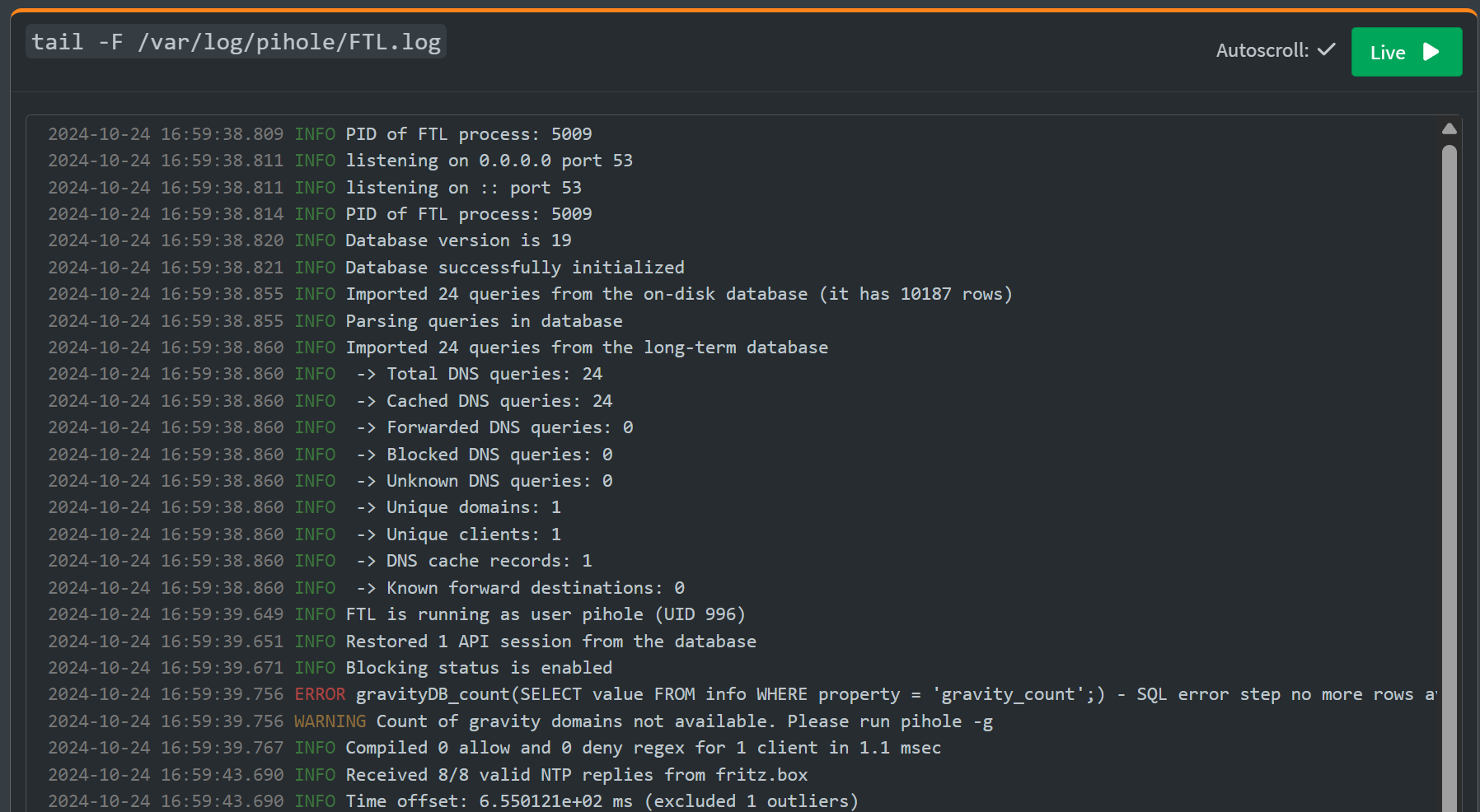

Yes, the question here is - as so often - the Why?
Looking at @TheME's debug token, /var/log/pihole/FTL.log is completely empty which is really odd as the mentioned function gravityDB_count() does log errors on each possible way that leads to -2
This is probably because DietPi uses RAMlog and the logs are cleared every hour by default.
I have now changed the setting to store the logs on disk.
