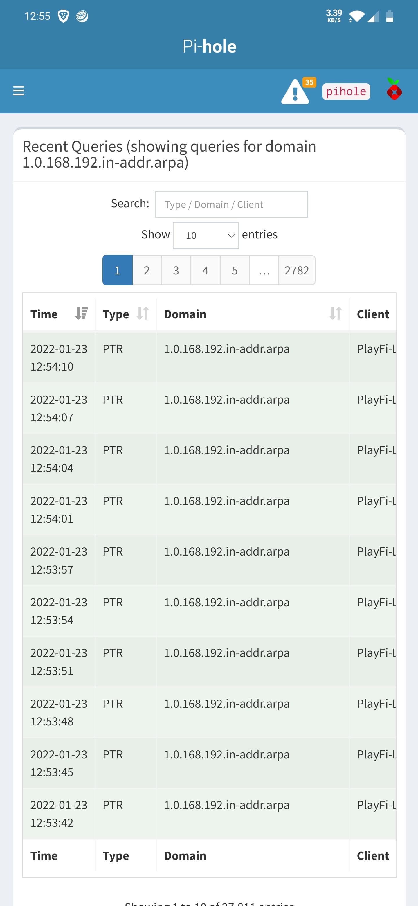

I have a Philips soundbar that looks to me making PTR requests every 3 seconds, none stop.

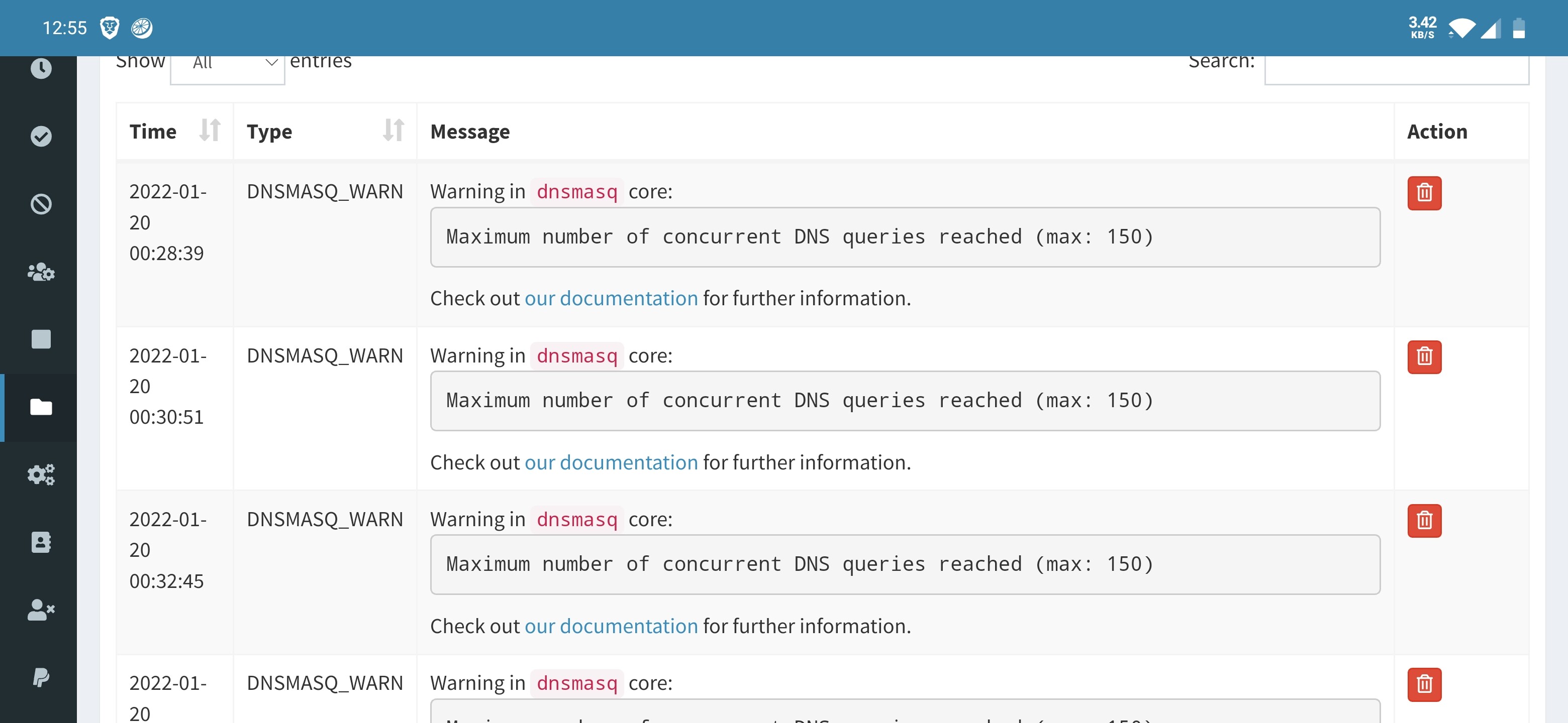

And I also have a DNS masq warning:
Maximum number of concurrent DNS queries reached (max: 150)
My assumption is the warning is a result of the 20,000+ requests from the soundbar?
Why would the soundbar do this?
It is querying 192.168.0.1, which is my router.

-rw-r--r-- 1 pihole pihole 11M Jan 28 22:27 /var/log/pihole.log
   -----head of pihole.log------
   Jan 28 00:00:21 dnsmasq[17838]: query[PTR] 1.0.168.192.in-addr.arpa from 192.168.0.70
   Jan 28 00:00:21 dnsmasq[17838]: /etc/pihole/custom.list 192.168.0.1 is skyqhub.lan
   Jan 28 00:00:24 dnsmasq[17838]: query[PTR] 1.0.168.192.in-addr.arpa from 192.168.0.70
   Jan 28 00:00:24 dnsmasq[17838]: /etc/pihole/custom.list 192.168.0.1 is skyqhub.lan

I still see the dnsmasq warnings...
Warning in dnsmasq core:
no address range available for DHCP request via lo
Still seeing the same DNS Masq warnings here,
And you will continue to see the same warnings as long as your soundbar continues to repeatedly request the same domain. This is outside the control of Pi-hole, which can only respond to queries it receives. That is what Pi-hole is correctly doing.
Understood now thanks.
It wasnt clear to me if the warnings were due to the soundbar.
