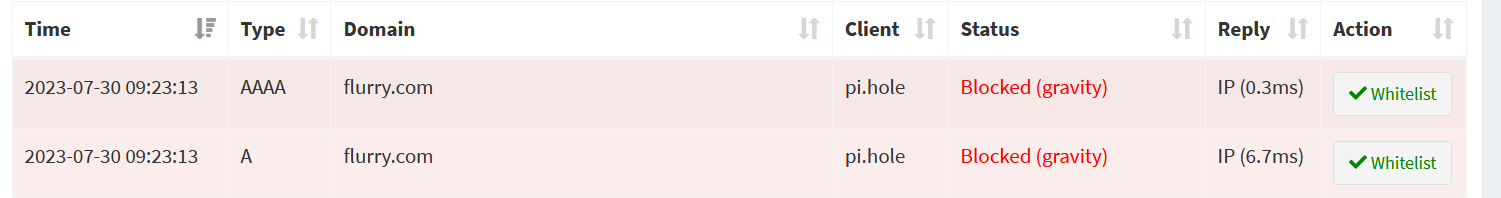

pi@pihole:~ $ nslookup flurry.com 192.168.11.101
Server:         192.168.11.101
Address:        192.168.11.101#53
Address: 0.0.0.0
Address: ::
I checked the logs after, and flurry.com was blocked (+2 blocked)
